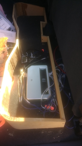

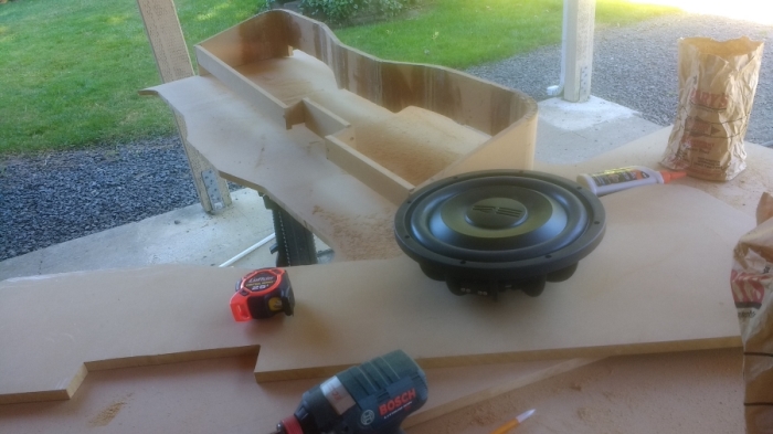

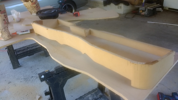

I have minimal space to work with, I'm attaching some photos so you can get an idea of what I'm hoping to do.
It's a down firing box for under my truck's rear seat. It's an RE Audio SL-12 D4 shallow mount and its minimum ported box size is 1.25, The only way I can maintain that is if I do an external/slotted port. The port will be going on the longer side of the box which will have 1.75" clearance from the floor. Since I can't do the port on the inside of the box, would a 10"x.75" be enough? using an online calculator, it says 6.75" long would be 34hz. Would that create too much port noise? Also, which way should I face it, towards or away from the sub? I initially planned to do it on the inside and have it face down like the sub but that's not an option. If I got some 1/2" plywood (I assume MDF is more likely to split) I could do a 10"x1" port, the calculator says it'd have to be 11" long which there's plenty of room for.

It'll be right around 1.25, I don't have exact measurements yet but it'll be roughly that. I'll line it with plastic and see how many cups of water it holds. I was doing 3/4" MDF where I'm mounting the sub but I'm going to do 5/8" instead. I'll get the 5/8" sometime next week to redo it. I'll get slightly more airspace and the sub is light/not very powerful anyway.

It's hard to tell in the pic, but the way it'll sit in there I won't be able to run a port out of the back. My only options are run the 12 sealed or run the 10 ported with an internal port.
The DSP is going behind the seat when I install the amp. I'm using the DSP's internal amp right now and I left the wires that long so I have more options when I mount it. Ignore the clutter
