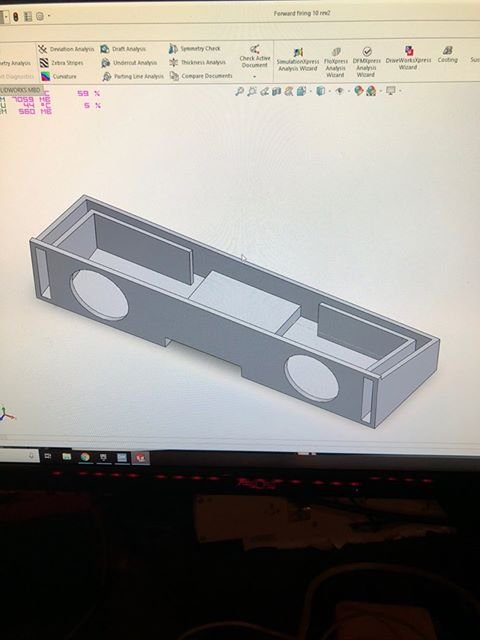

On 10/23/2017 at 11:01 PM, IxsharpxI said:
so this last pic i was just comparing mounting depth and magnet sizes of front mounting and down facing w3, w6s and w7s.. and then my design for the dual 10" w7 box. i haven't added my port yet as i am still working in Winisd.. but you get the picture. my calculations put me at around 2.5-2.75 cu ft
SOLIDWORKS, so I am not the only one that draws them up in it also.  So what are you supposed to be ding with it instead of speaker boxes.  lol

I have been working on the design for a new box with a second woofer. using WinISD i programmed a 2.5cu. ft box,  32hz, 1.5 x 9x 25.75in port. Recalculate my airpsace and im down to 2.15 cu. ft after all the port and wood space. I'm not sure where i can sacrifice..not to mention the more complexities of the shape of my box how accurate it will be.  i have a box now tuned at 34hz and am wanting to go lower. this design has a much flatter curve then my current design.

I like the new design!
