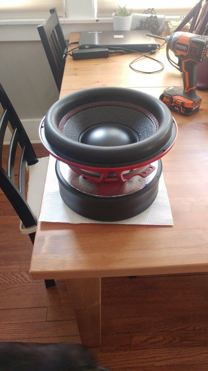

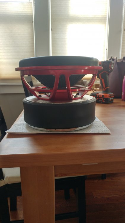

bmwking Posted February 6, 2018 Author Report Posted February 6, 2018 bet you guys thought i gave up on this huh? nope, just taking my sweet ass time because life. got my cone, basket, triple joint ring, and glue in today. just waiting on my coil, spider, and possibly some terminals (havent decided if i want to direct connect or not) here's progress: gonna be a pretty beast 10 i hope
