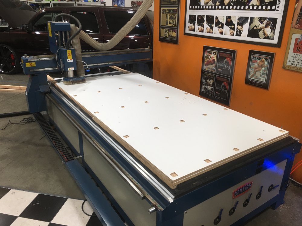

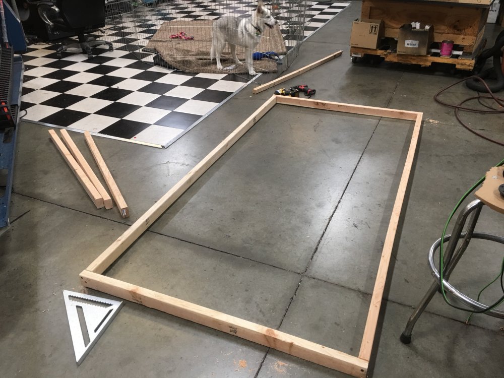

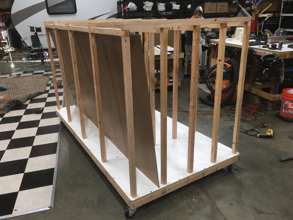

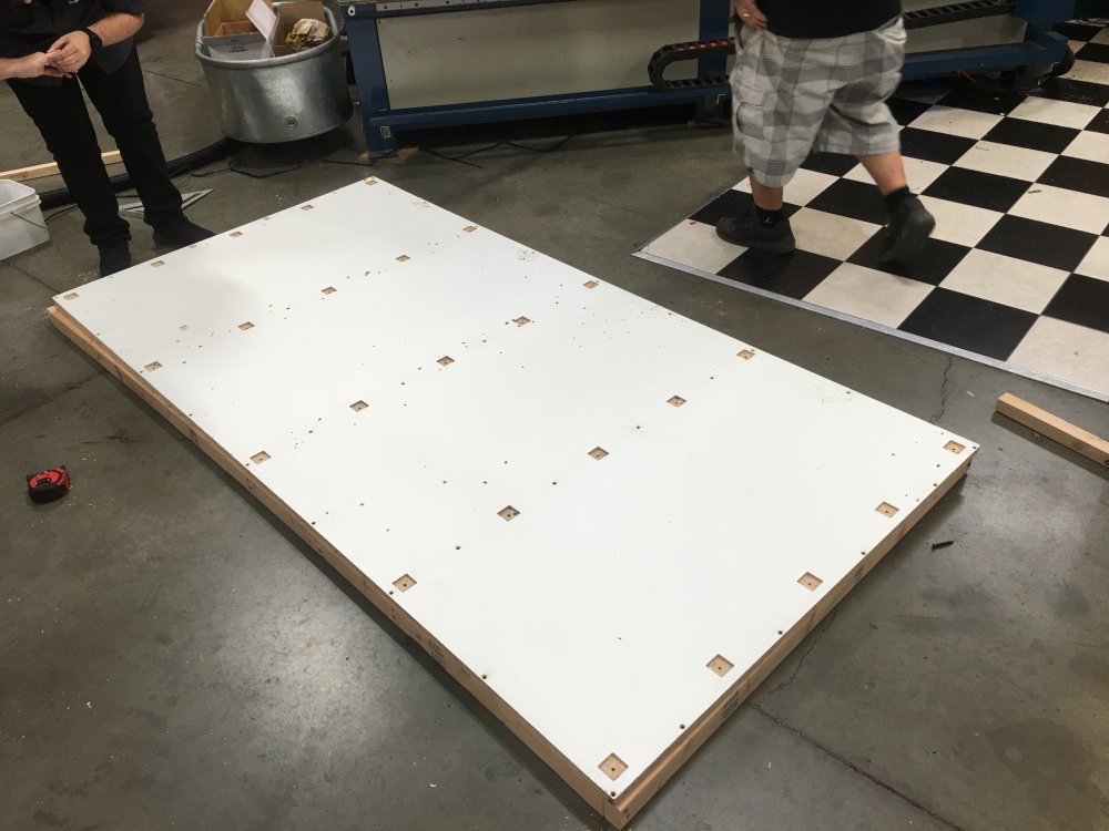

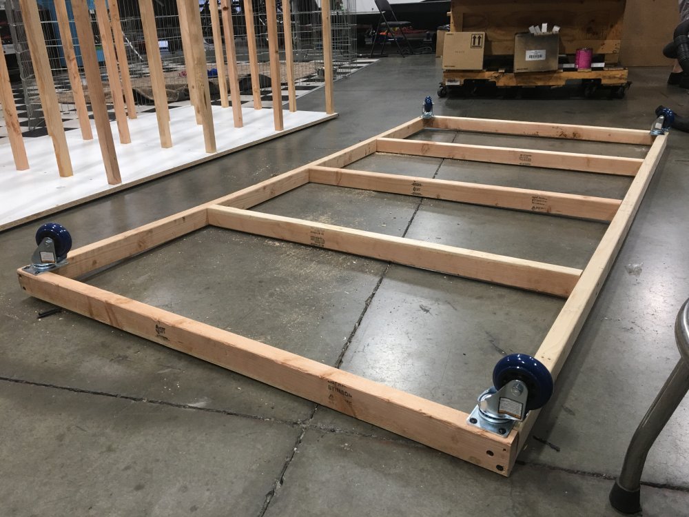

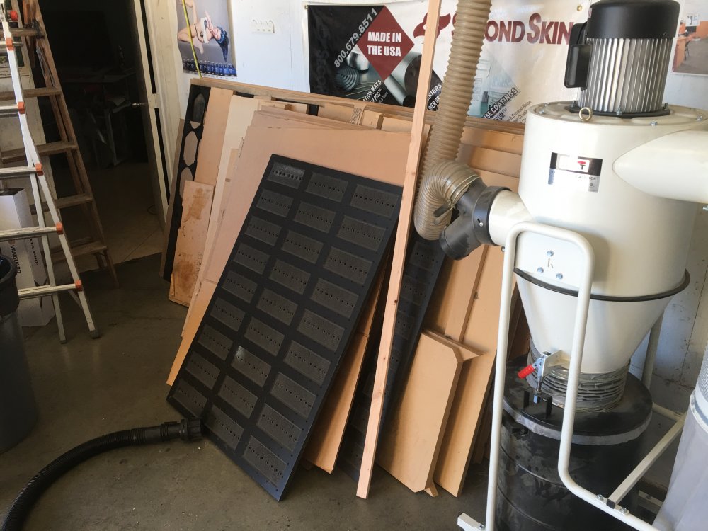

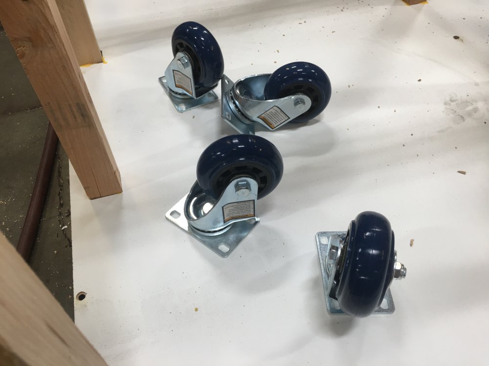

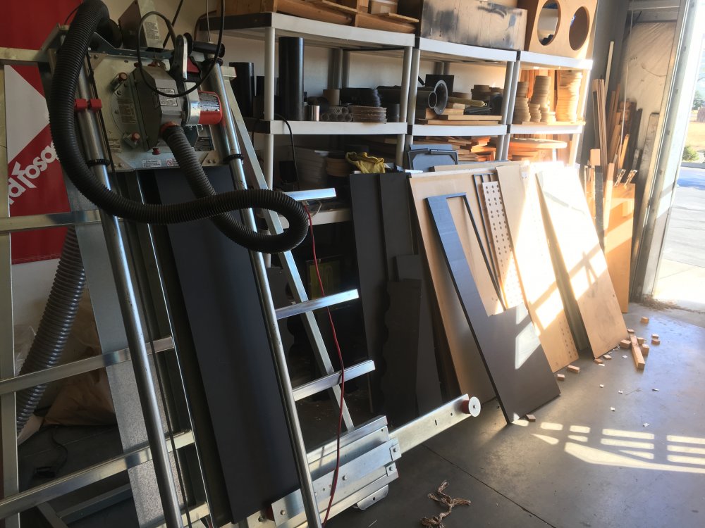

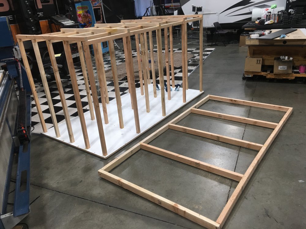

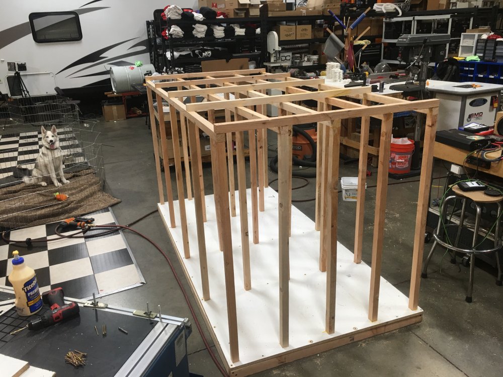

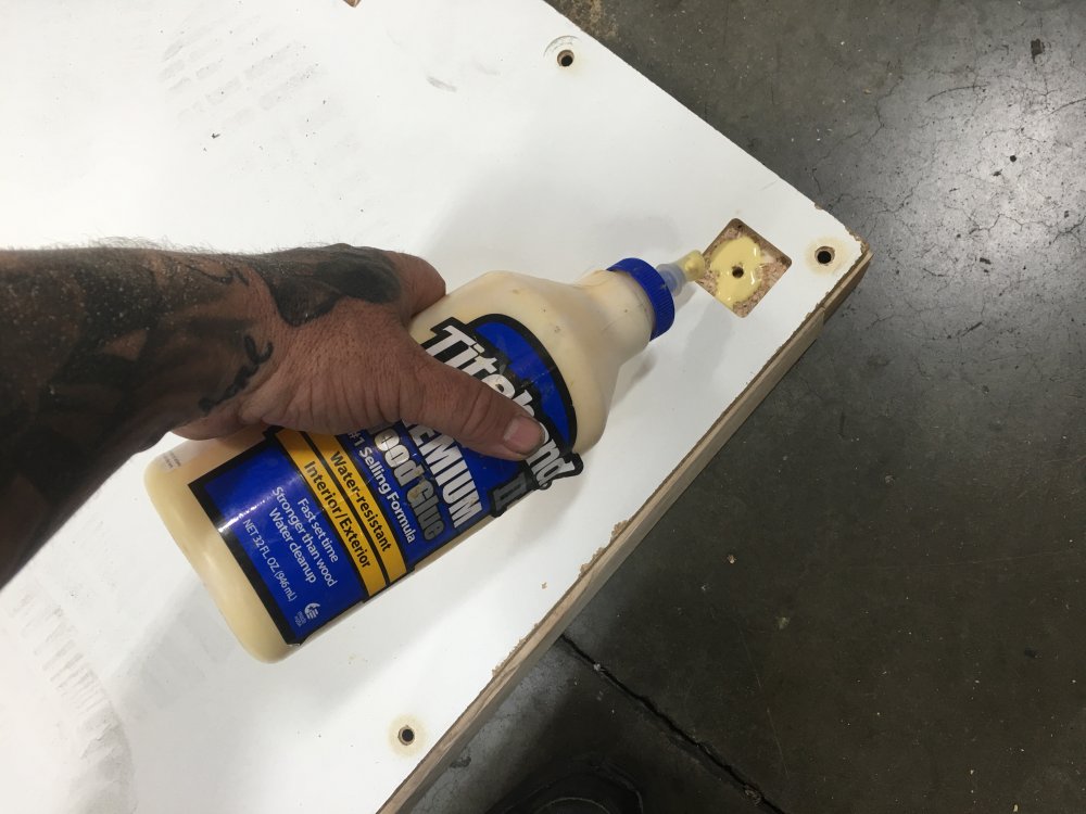

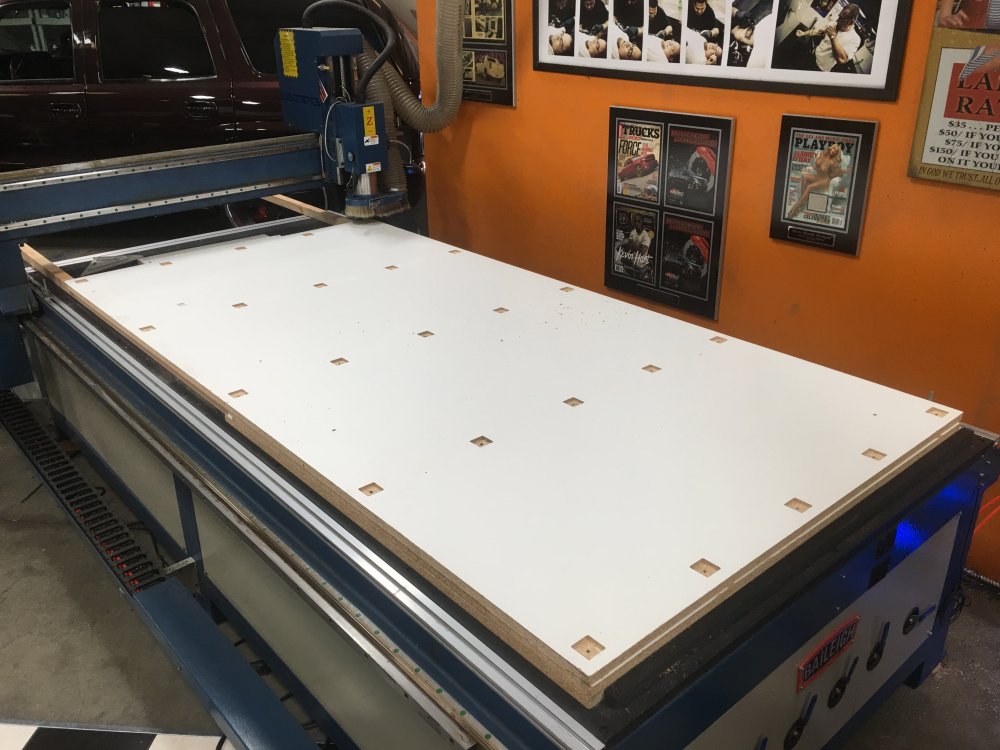

I don't know how other people that own CNC machines do it, but for me, i see EVERY scrap as valuable so i throw nothing out.  If i can't make something i can sell with a piece of scrap, i damn sure can use it to proto-type something else i can sell later.  Anything larger than a 6" circle can be used to practice something else on if i need to :D  But that causes problems.  I have everything from brand new flat stock (MDF, PVC, Acrylic, plywood etc), i have half sheets. I have quarter sheets.  I have stuff with chunks taken out....i have it all.  I have 4 separate "stacks" of misc stuff that i cannot throw away leaned on 4 different walls in my little wood shop area.  It is OUT OF CONTROL.  Plus, when i do need to grab something out of the pile, i can't get to anything because it's up against a wall.  Not to mention the longer it sits, the more of an angle it takes on.  This makes precious sheets of whatever start to bow a little over time.  I have wanted to make something for about a year but i just have not had time to design something.  Today, over a hot cup of coffee, i went for a pre-dawn run to Home Depot and got a bunch of wood and some casters. I drew some stuff up free-style on the CNC and went to work.  As of today's posting, it isn't done yet. But i hope to have it done tomorrow.  I want the glue to dry before i flip it on it's side and put the casters on.  I also want to sheet each column out with 1/8" or 1/4" MDF.  So tomorrow, ill have more updates!+89+9+/*

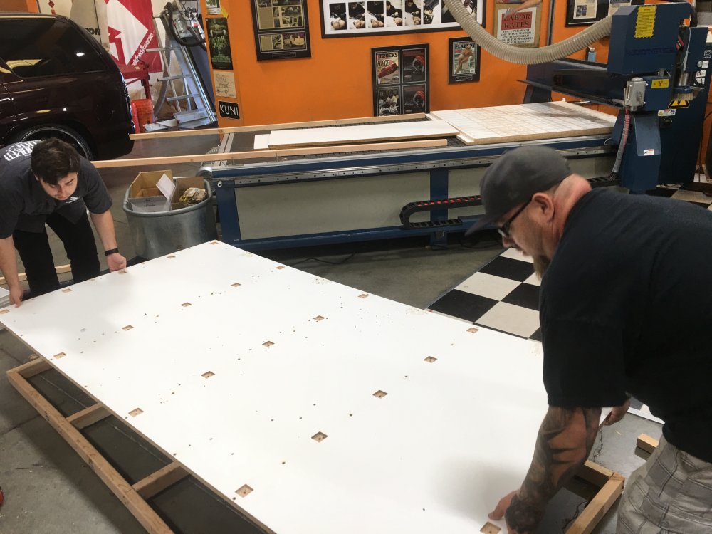

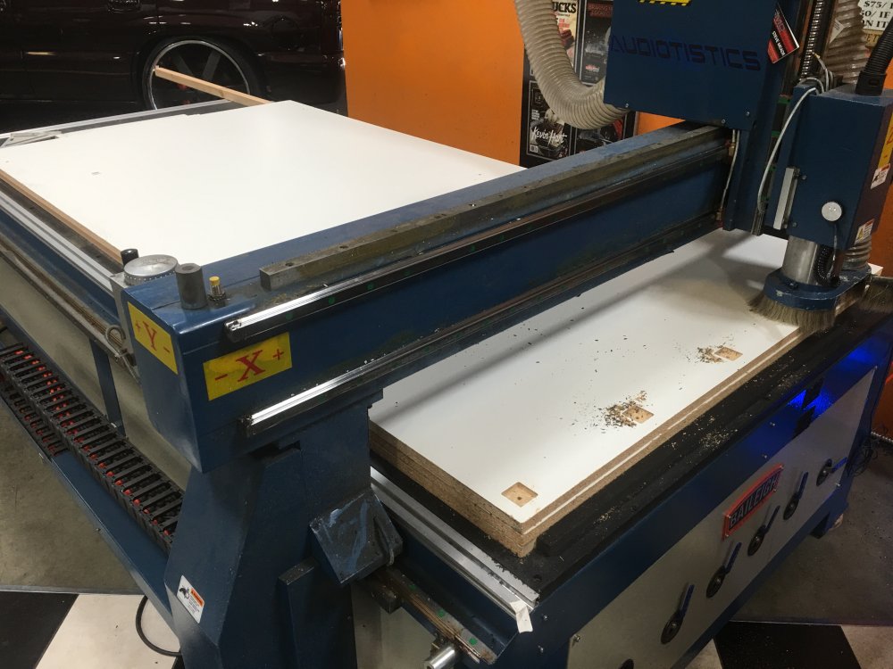

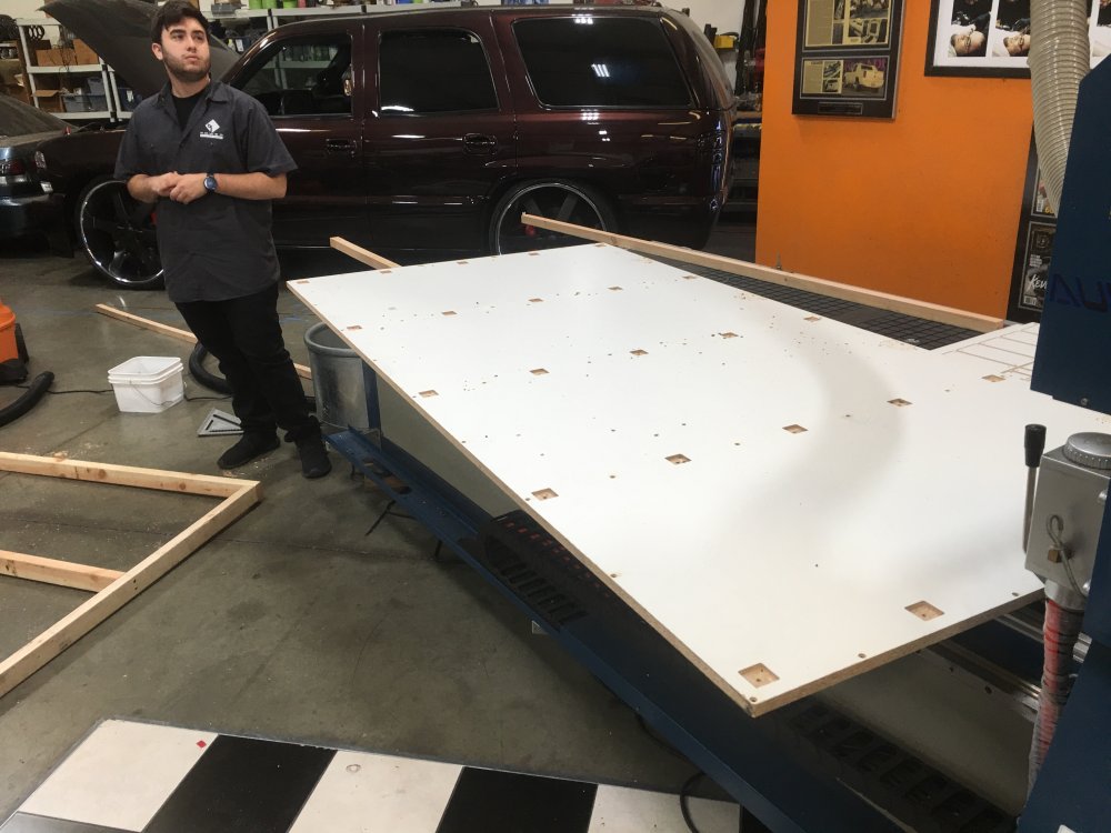

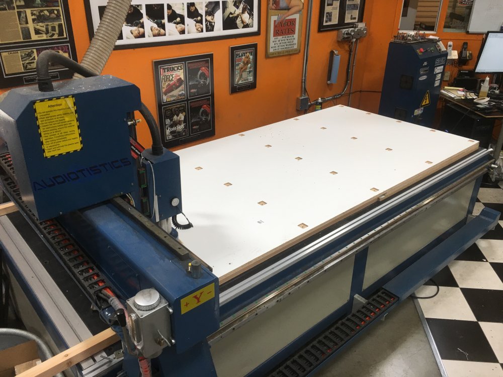

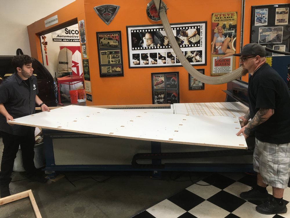

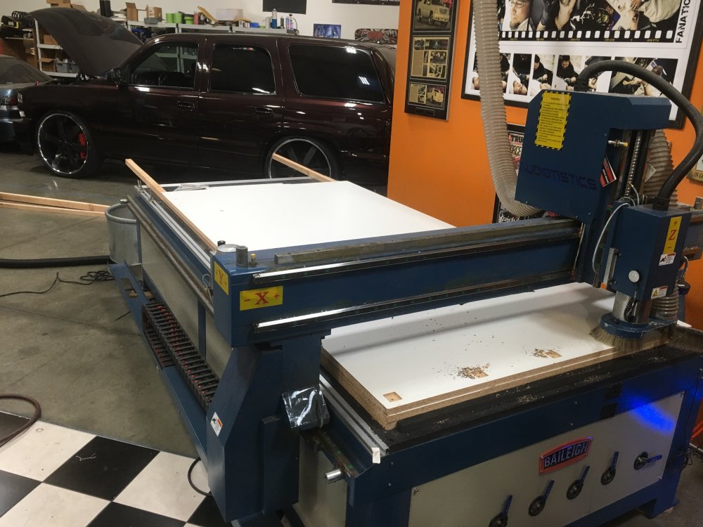

I have to say, it is rare that i use the entire table.  It's been a while since i had the machine that far on the other side.  :D

Must be nice to have the machine do all the work for you ?
just busting your balls steve. I know how much you like it when people tell you stuff like that haha

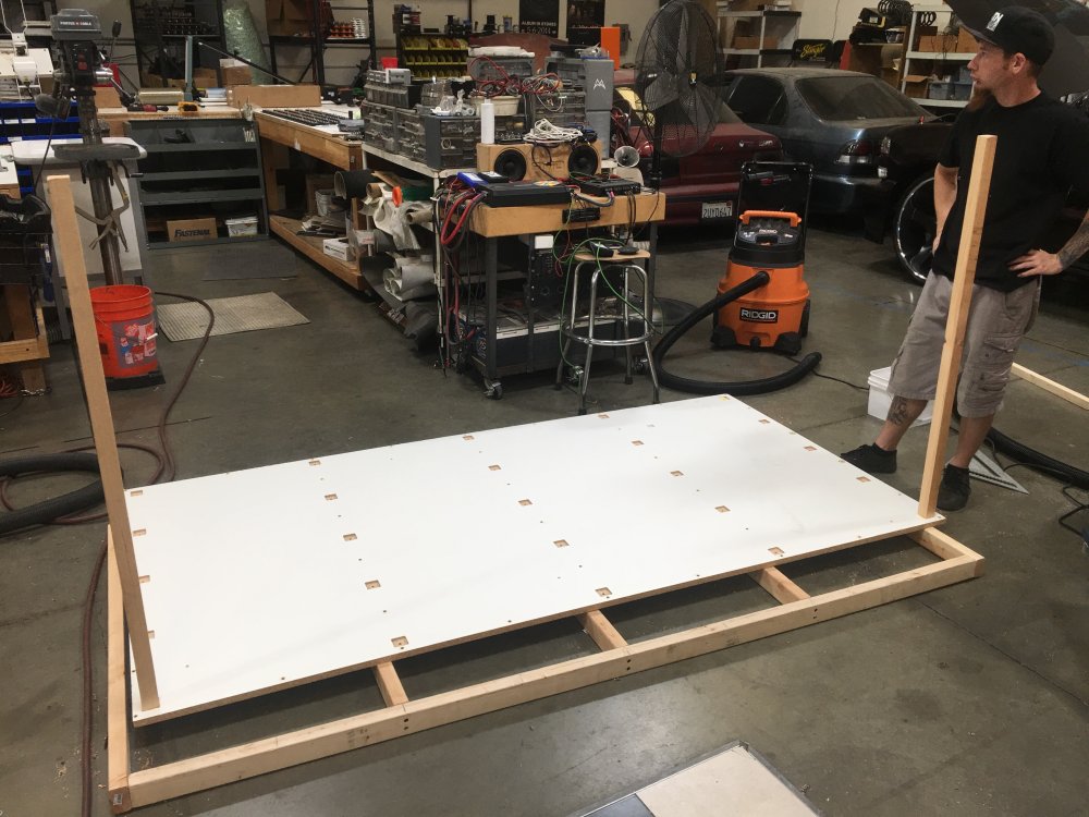

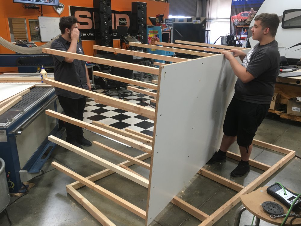

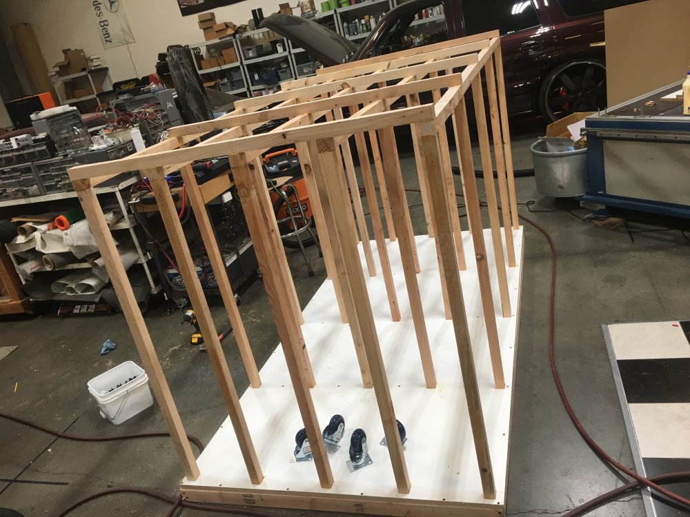

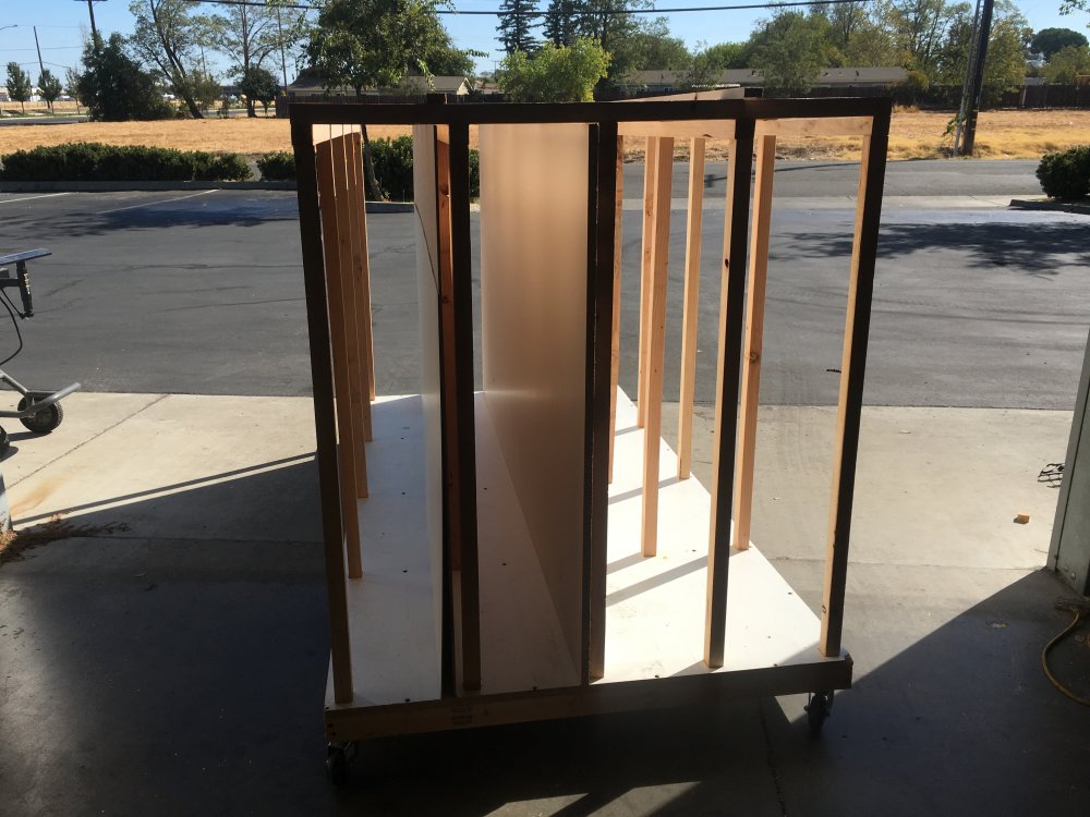

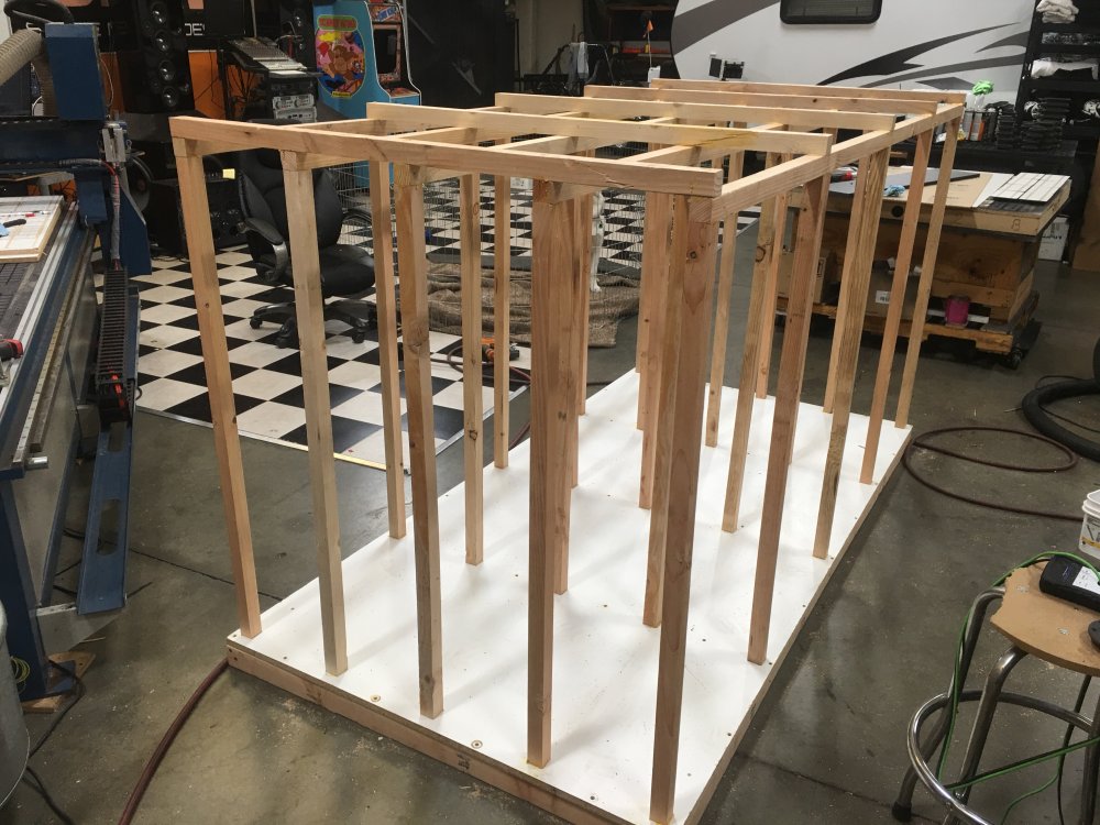

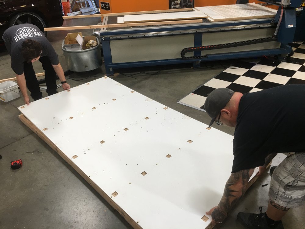

Oh also, just had to vent a little...this was a challenge to put together with that SHITTY ASS HOME DEPOT WOOD.  Jeeeezeeee....i didn't realize they were all that shitty when i plucked them out.  I guess i was in a hurry.  Nasty ass warped wood....oh well i made it work.  I bent most  of  the bad ones into shape as the project came together.  :D  Tomorrow i will sheet all the sides so it's 4 solid little area's.  Should look and function very nicely.

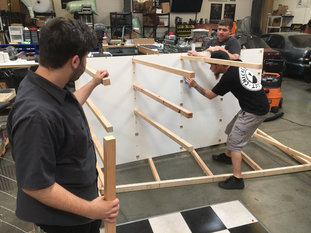

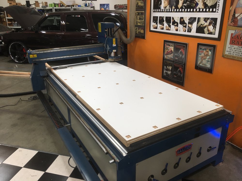

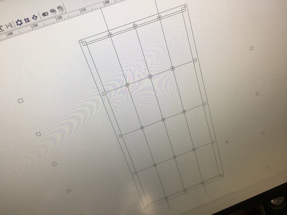

it is kinda nice haha!  But really though it took me over an hour to get everything the way i wanted it on the screen before i even started. Everything is aligned really nice and consistent.  It is fun to make stuff for the shop with that thing :)

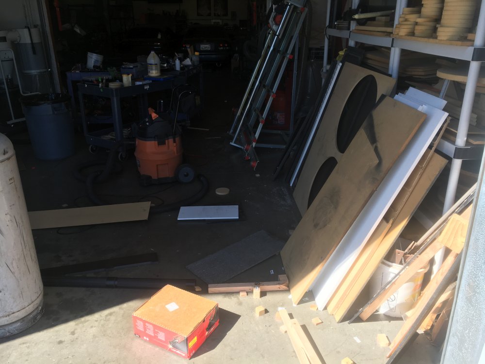

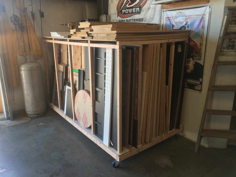

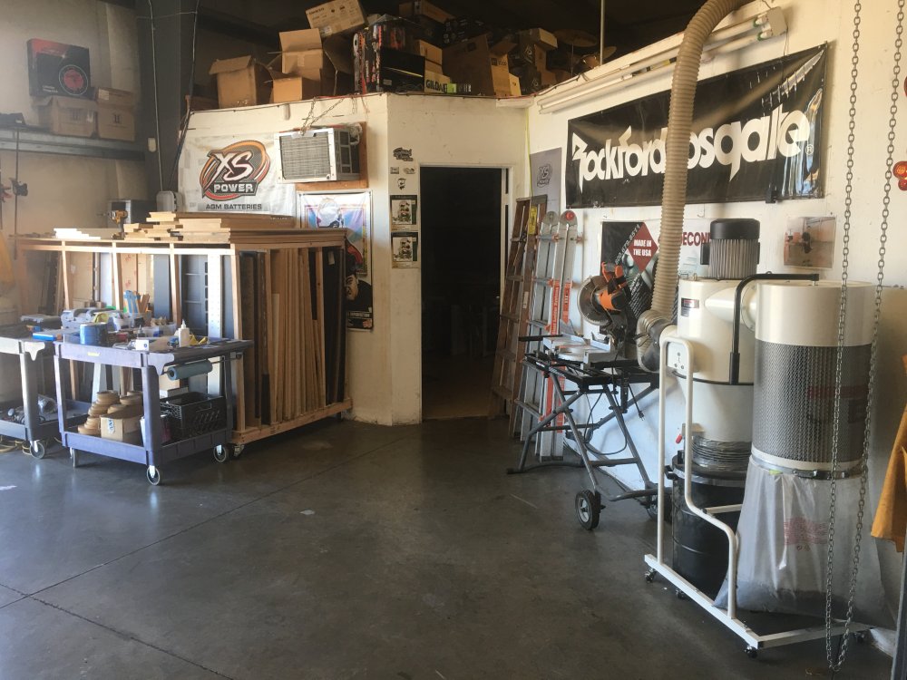

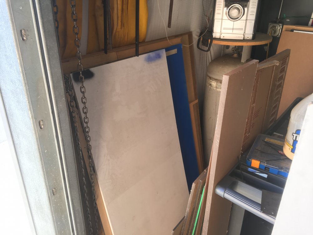

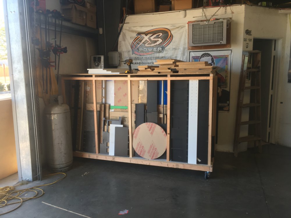

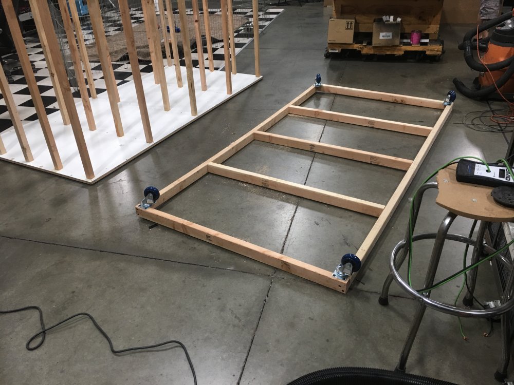

Ok check out these random piles of stuff...that are about to disappear. :)
Follow my Tweet (Twitter)
  • Like (+1 Rep) 3

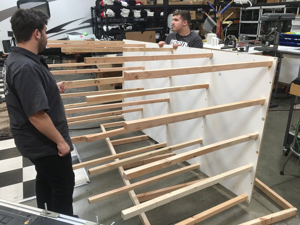

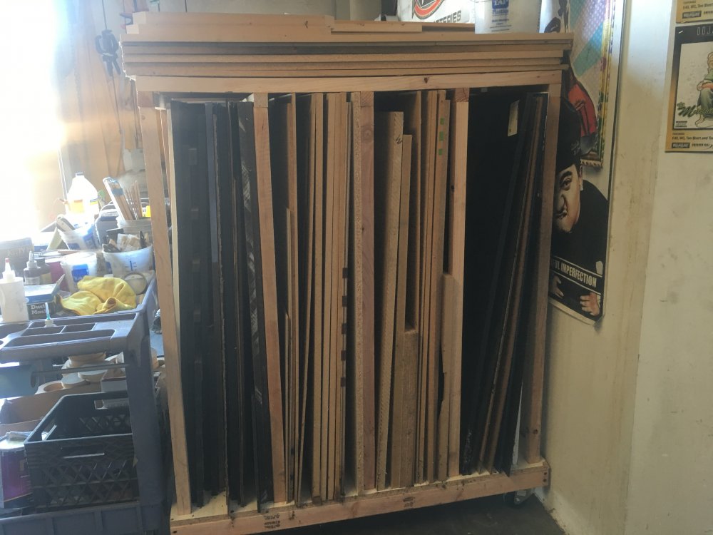

ahhhh feels so good to have that done! I still have room for more too!
oh...and i am sure there is a much better way to make this...and i already have ideas that could make the next one better. But this was freestyled off the top of my head.  Works great so far :D
