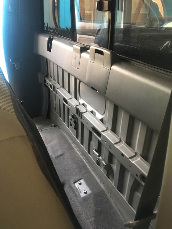

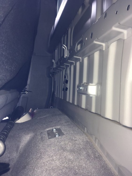

theaestheticgreek Posted October 10, 2017 Author Report Posted October 10, 2017 Ya no I agree it would be more power than needed but I wouldn’t overdo it. Keep the gains down n keep the signals clean ya know? Anyhow, I can show you where the box would sit. Been busy today but I’ll take some pictures real quick. I mean you could make the box hatch style if you wanted but... it’s just a regular cab pickup so space is limited and the amp would have really nowhere to go but to screw into the box. Which would do nothing but take up space but I think by mounting the amp lower on the box (where the seat doesn’t come as close to the cab) we’d be ok. Not to mention sub mounting depth. But I think even at 7.5 deep (external depth) we’d be ok. But I’d just put the sub at the bottom passenger or driver side facing against the back of my trucks bench seat. With the port being on the opposite side of the box, firing up out of the box... so... what? 3 common port walls I’d say? Anyways I’m gonna go take a picture. But I’d just like for the sub to be able to play decently low. Nothing crazy low.. if it played down to 30hz it would be cool but it’s an L7 and I’m not trying to push this sub like I would other setups I’ve had.

Joe X Posted October 11, 2017 Report Posted October 11, 2017 Ok so the following could be one way to do it, sub forward port sideways non slanted box, 8 in depth is 6 1/4" mounting depth + 1/4" sub clearance to the rear wall + 2x0.75 for the wood thickness front + rear totals 8" depth, I think it will fit, if not then a slanted box could be tried but it's harder to build or port up as you planned before something wider and not as tall. To know if a particular box size will fit I usually recommend building a cardboard test box to test fit. Power: to sub rated, amp subsonic filter to 28Hz, minimum port clearance 4 1/2", figure is just an assembly guide:

Joe X Posted October 12, 2017 Report Posted October 12, 2017 Yes port firing sideways is a common and often successful configuration for your type of vehicle but here is also the one you wanted, port firing upwards.here's the 8" depth version that wouldn't require a lift for the sub, it has larger net volume so one needs to be very careful with input power and the SS filter setting. Power: to sub rated, amp subsonic filter to 28Hz, minimum port clearance 4 1/4", figure is just an assembly guide:
