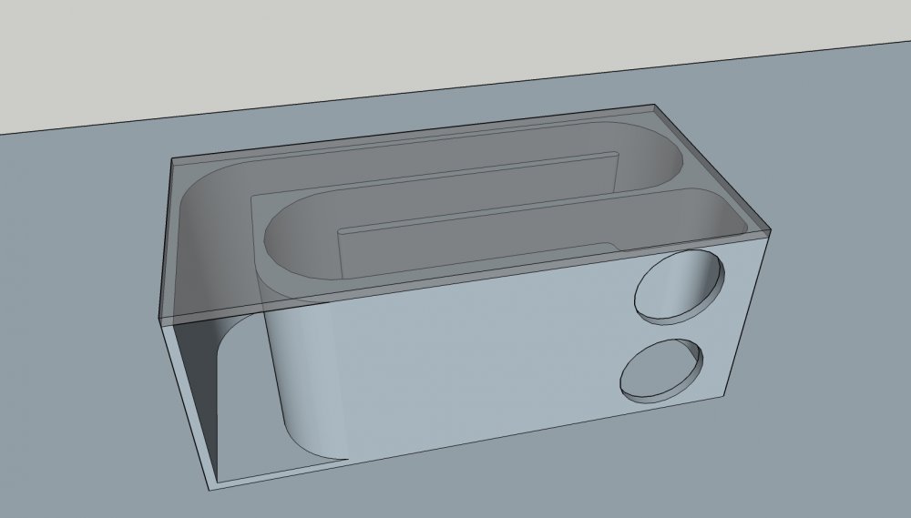

dual Sundown X8 v2 Tline for SQ build in future jeep.... thoughts.
would be building/cutting on my cnc, 22 identical layers stacked. with a .75" base and .75" plexiglass top for internal viewing. 1200watts roughly to the pair via an Alpine PDX-M12
might swap subs with dayton audio ultimax 8s and just run a Alpine pdx-v9 for everything
44" wide
18" tall
21" deep
tuned at 30hz with 90in^2 port area

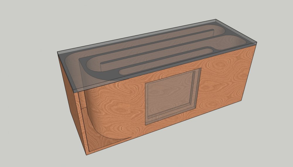

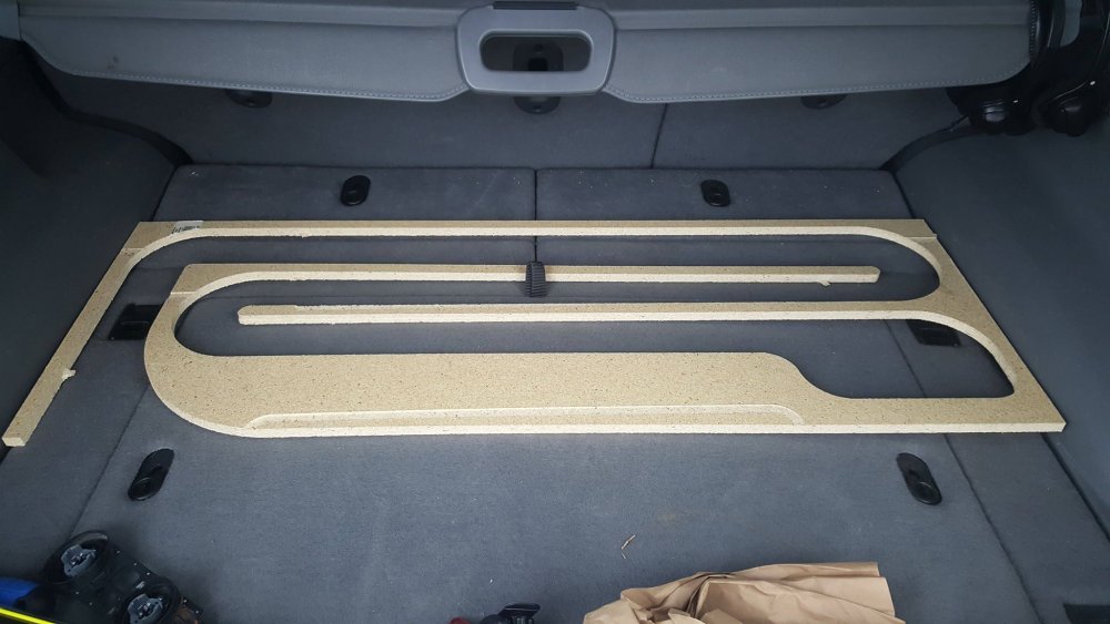

so far, very slow progress... had to set up my new cnc table. but a final design for 2-8" subs and a new box layout. also a first test cut using ply wood for fitment and tab placement.
