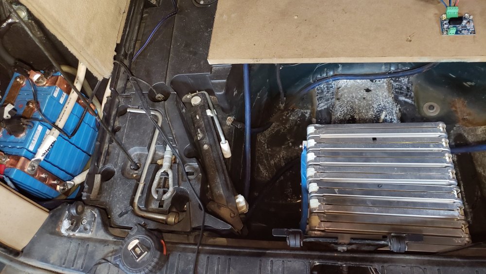

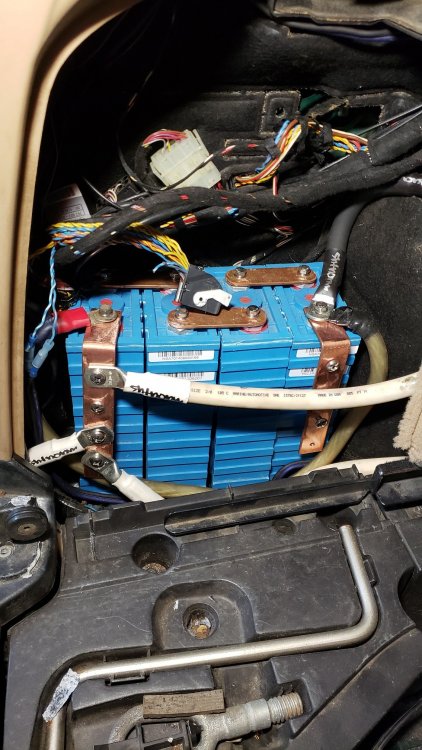

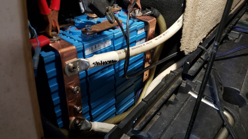

bmwking Posted November 5, 2017 Author Report Posted November 5, 2017 Just a report back, got to drive and beat on it today. All my hardest hitting demo songs, just wanging on it (as much as it can)... Could NOT get the voltage to drop below 13.9. And whenever it did it was almost instantly back up to 14.5. lithium FTMFW!!!! Blows my mind. So excited to have the electrical mostly sorted. Now time to source some new subs, can't decide if I want to wall with 4 xfls or do 2 monster 12s on 5k...
bmwking Posted November 5, 2017 Author Report Posted November 5, 2017 FYI, added purchasing details for my lithium setup in the post with the pics of it
mmpannekake Posted November 5, 2017 Report Posted November 5, 2017 looking good, did mike have to do anything special for your alternator to fit or did it just bolt in with the normal pulley? did you run your wires on the drivers side of the car or did you just route it in the back of the engine over from the passenger side?
bmwking Posted November 6, 2017 Author Report Posted November 6, 2017 21 hours ago, mmpannekake said: looking good, did mike have to do anything special for your alternator to fit or did it just bolt in with the normal pulley? did you run your wires on the drivers side of the car or did you just route it in the back of the engine over from the passenger side? I actually sent mike my old failed alt so he had something to work from, luckily he had already done alts for the e39 (and several others) and knew what was going on. he added a pulley, i use the outer 4 ribs of the pulley and it works great, tho i think i'll need like a 5mm or 10mm shorter belt to combat startup squeal. as for the 2/0, i ran it down the drivers side. took out the driver's seat, ran it up under the drivers cabin filter then out to the alt. it was ultimately very low effort compared to what i was expecting, knowing bmw and tight tolerances lol
