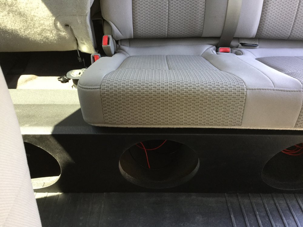

Hey all I was wondering if anyone has or can design some plans for Dual Sundown SA-10's in ported box under the back seat of 2010 f150 xlt supercrew. I am doing a seat lift to accomodate the designs. I am looking for the design mainly because I can build the box myself I have everything to do it with (almost).

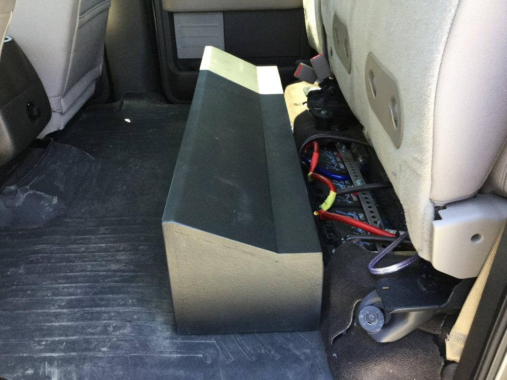

Won’t fit tried myself, ended up doing 3 in a sealed box under seat with seat lift
Port takes up all the space, the only way to make it work would be to make an external port that goes up the rear seat back . Sealed box is .7cu each chamber for 2 ported need 2.50cubes Plus port the math just doesn’t work. Sorry man and if I’m not mistaken the new SA’s don’t won’t a sealed box but I could be wrong, might need to find older models. 3 SA’s sealed still slams though.
I’m guessing your box would have to be around 3.5cubes internal to fit speaker displacement and port displacement.

Man i bought 2 sa-10s to replace 2 p3sd2-10 shallow mounts, and i fell for the rookie prefab fox box. The sa-10s arent much louder if at all. Disgusted with it.
