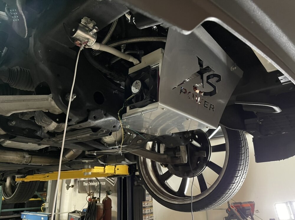

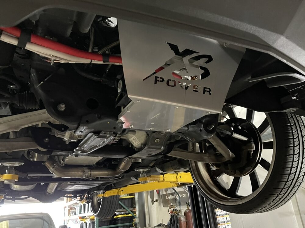

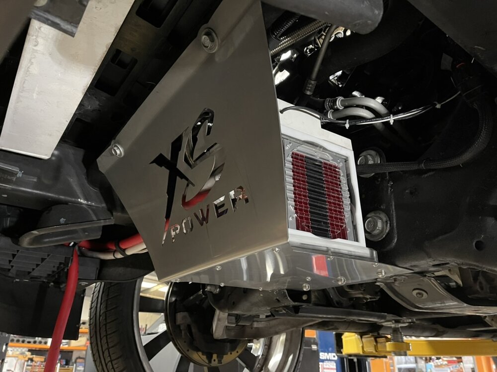

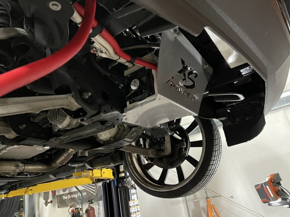

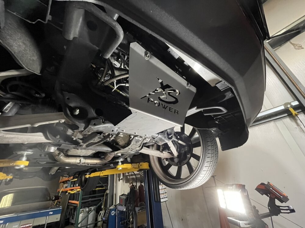

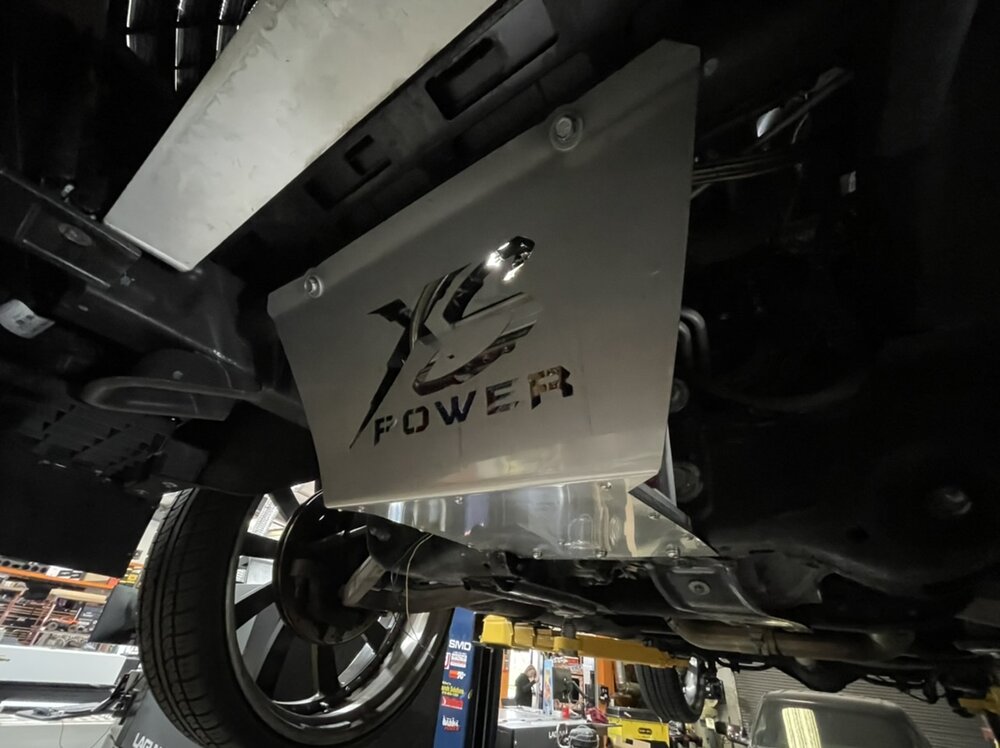

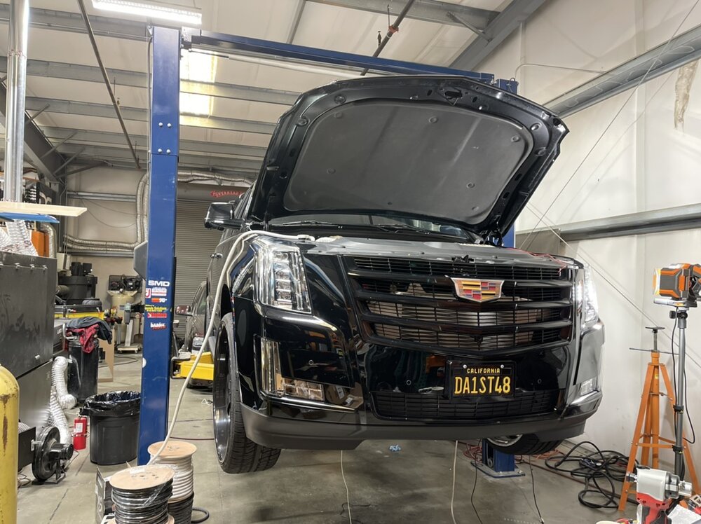

this will be a great spot!

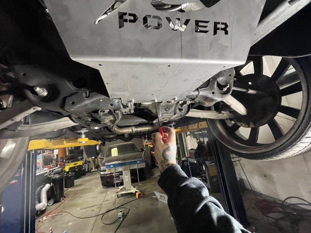

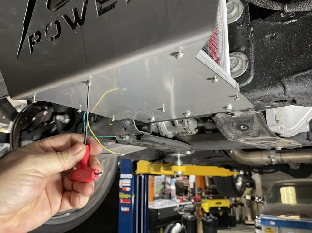

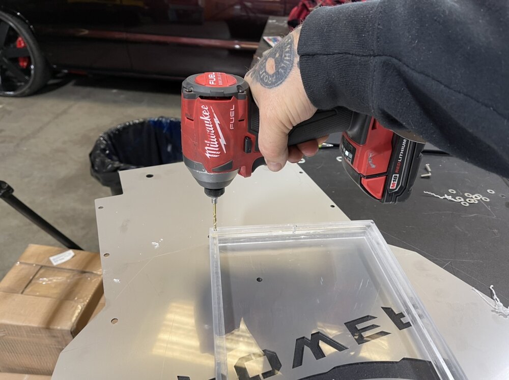

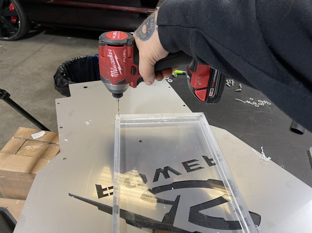

drilled/tapped using 8-32 Stainless allenhead bolts.
Follow my Tweet (Twitter)

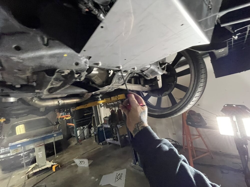

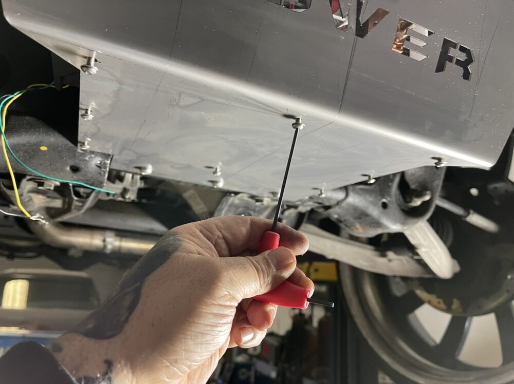

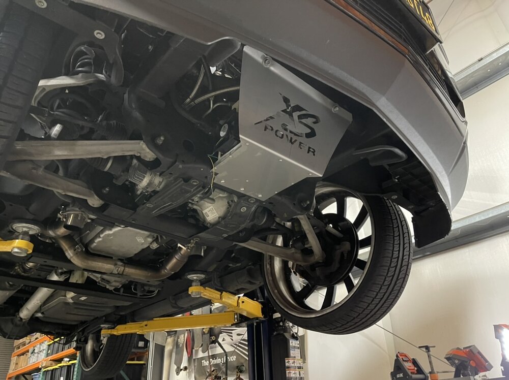

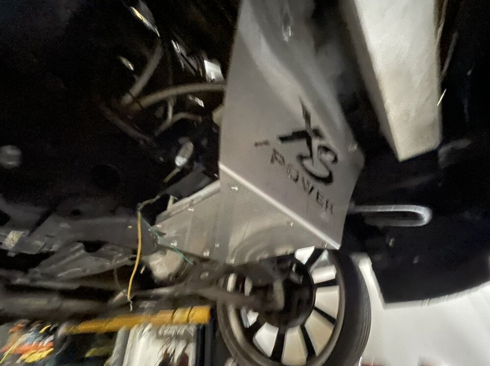

more drilling/tapping into the frame for these 5/16 x 18 stainless allenhead bolts.

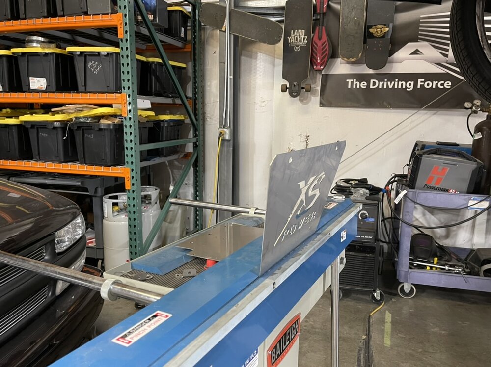

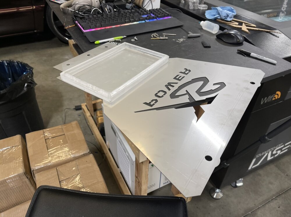

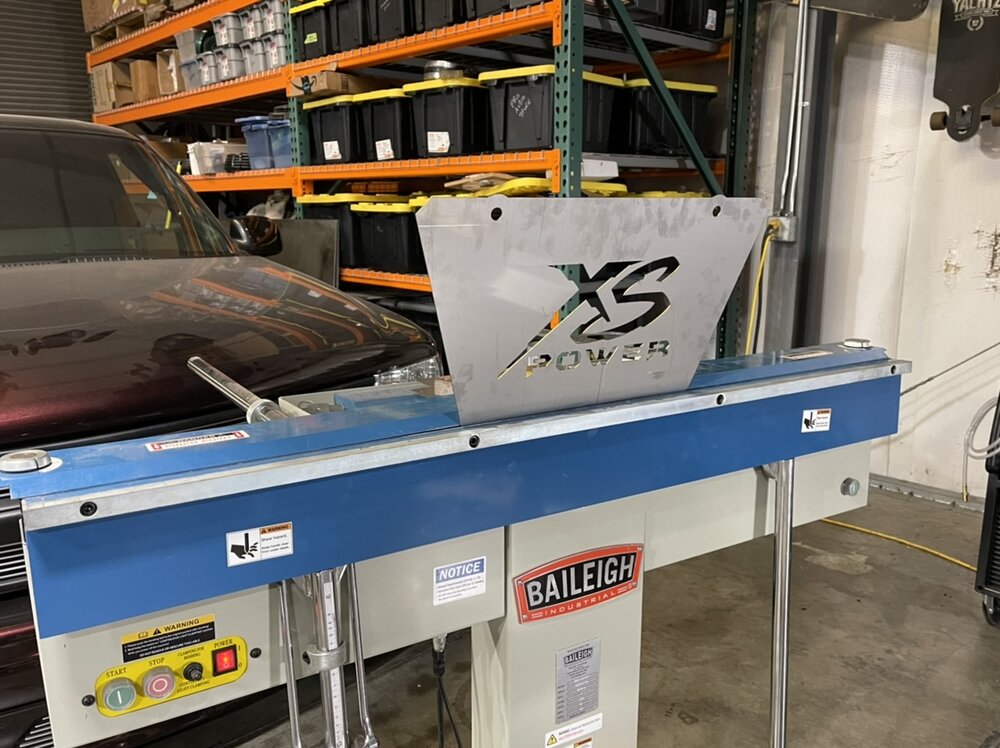

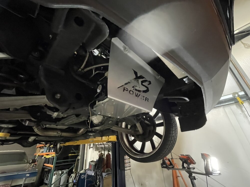

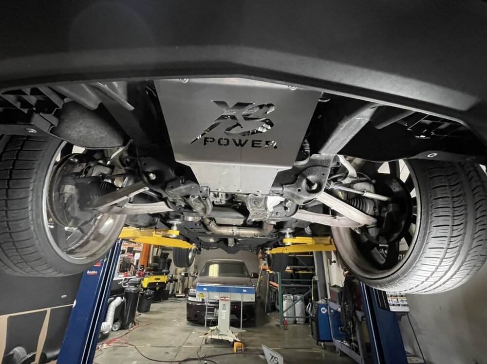

The step down box is VERY secure! This 16ga Stainless is solid as a rock bent in this configuration. The base of the step down box also helps it's rigidity some too.

That is brilliant! Skid plate and multi-functional! lol That should prob help keep it cooler as well.

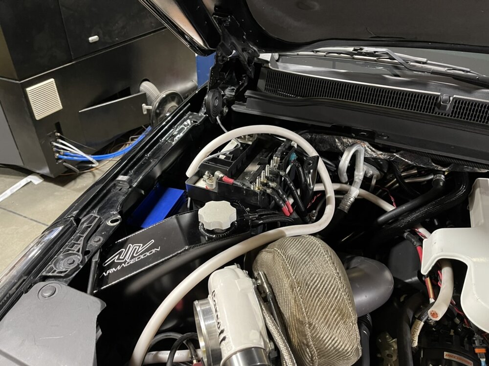

So, umm, what is it with the connector into the wire harness there?
10501650_10203332501847103_1859383749711
Blown
the connector (aka short circuit lol) shuts off the pesky battery light! CHYEAAAAA im in! lol

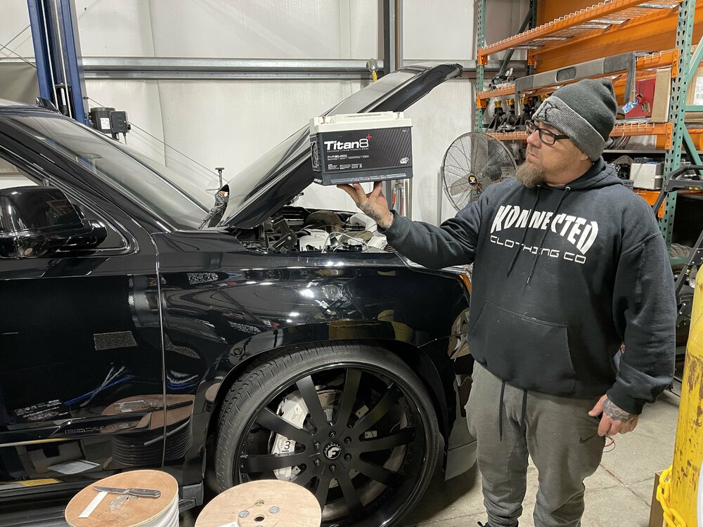

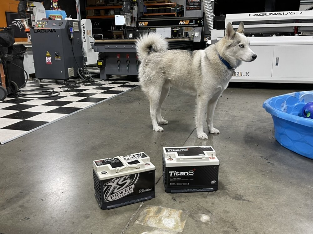

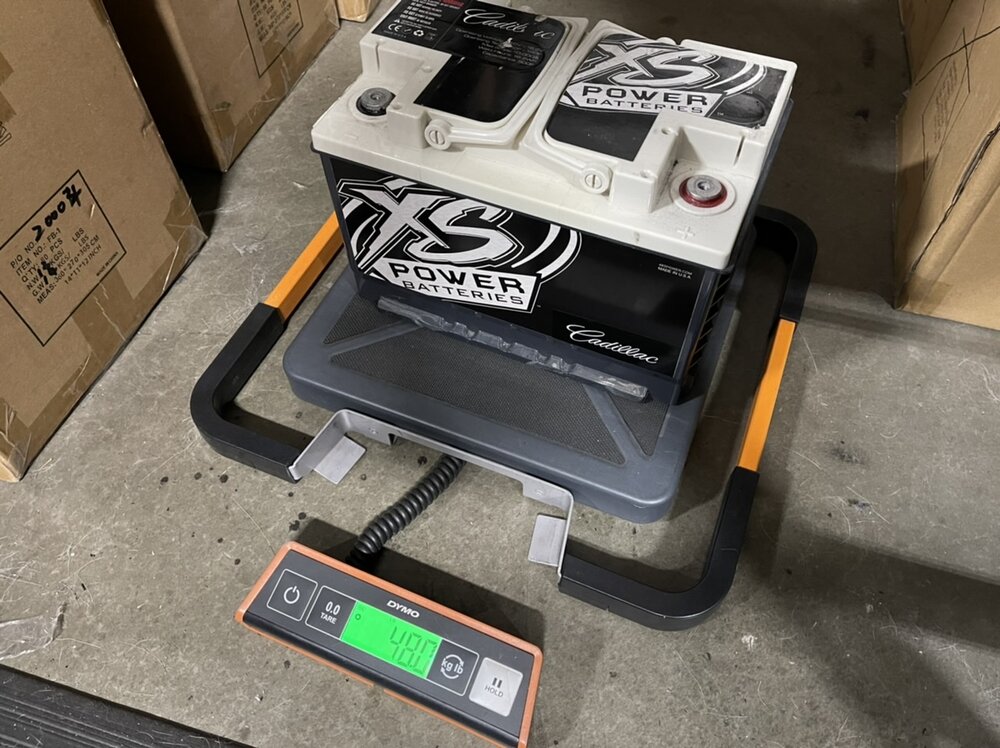

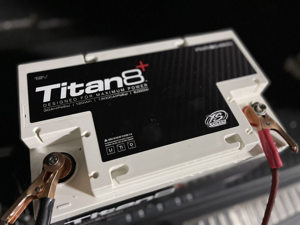

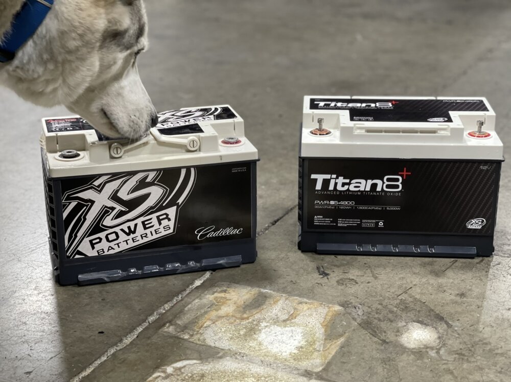

My XS Power 12v Titan 8 S5 4800 arrived!  Thanks for the fast shipping Showtime!  This is JUST for the engine and other factory accessories.  The rest of the system is on the 14v S6's in the back.

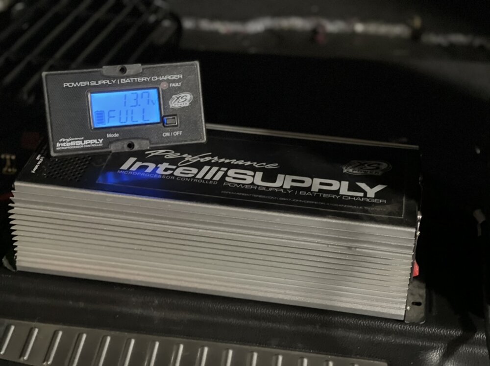

I quick charge..and i mean QUICK! these things are fast!

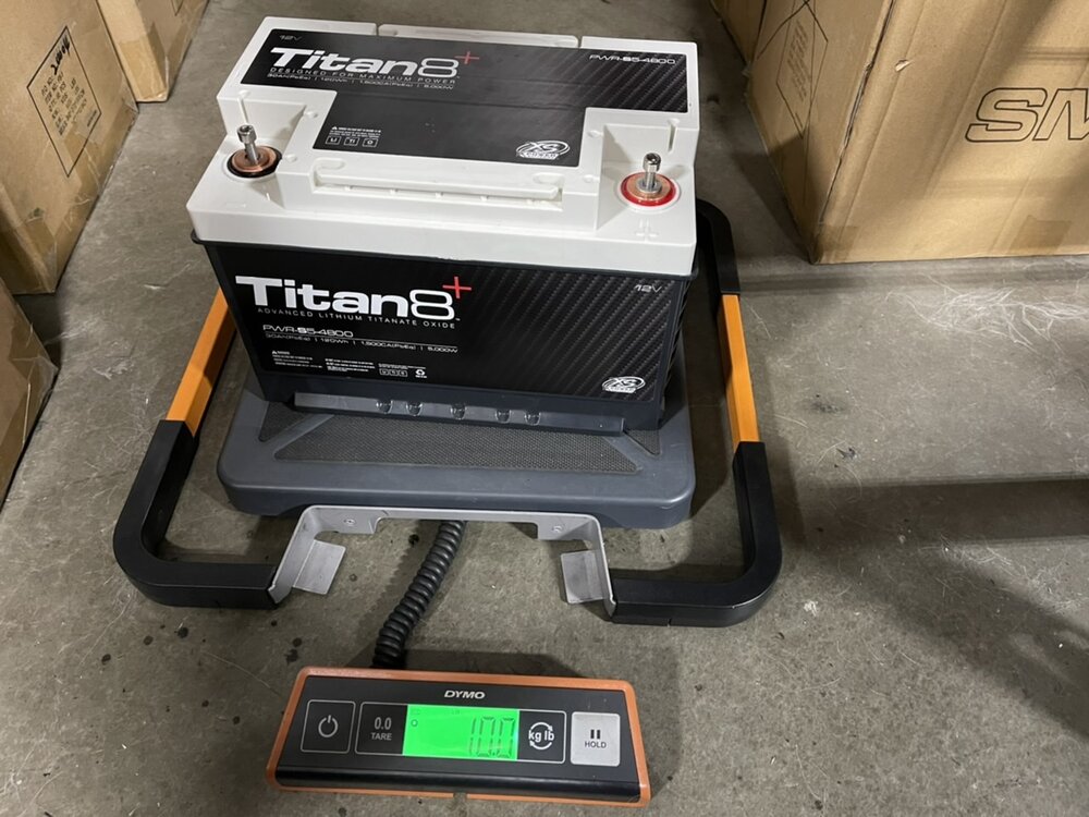

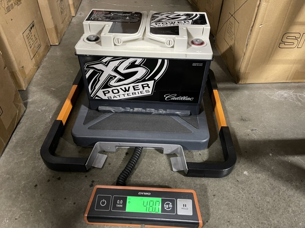

AGM vs. Lithium.  Forget about how much more power the lithium has. This right here is a game changer.  10lbs vs 48! That is almost 5 times lighter! wow!
Nice! I kinda thought that, but wasn't sure. Tricking it!

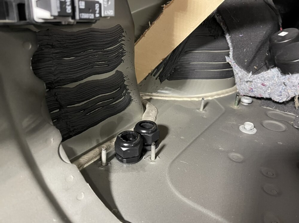

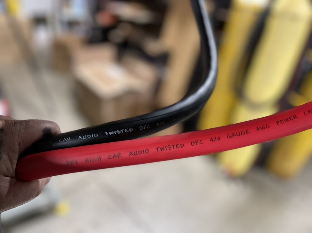

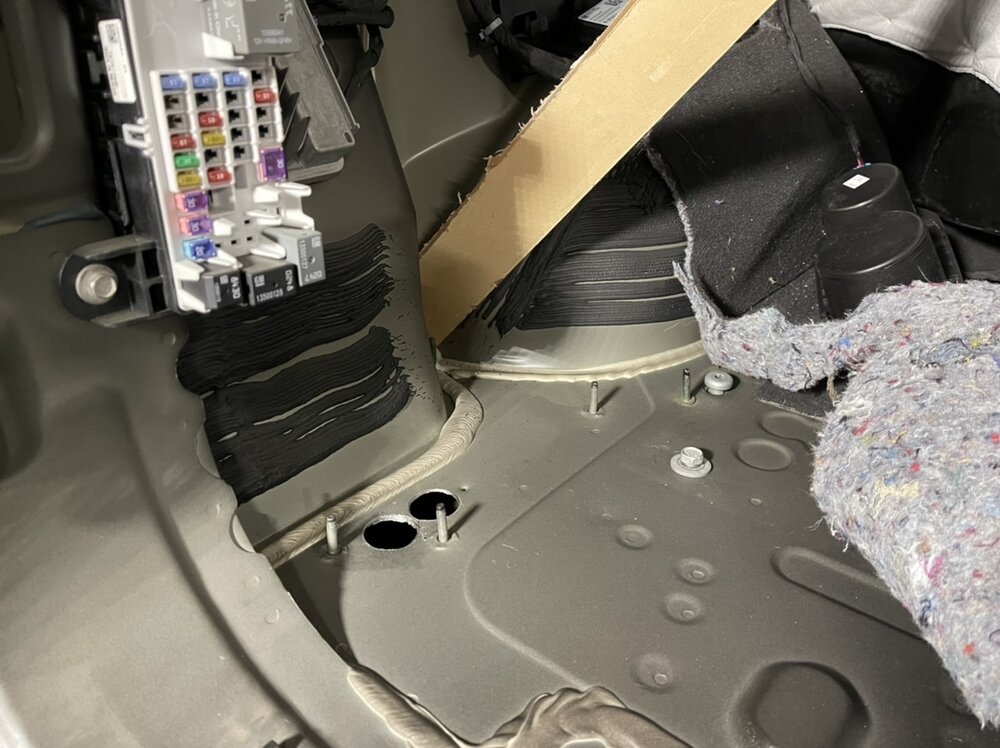

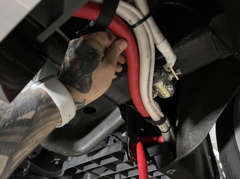

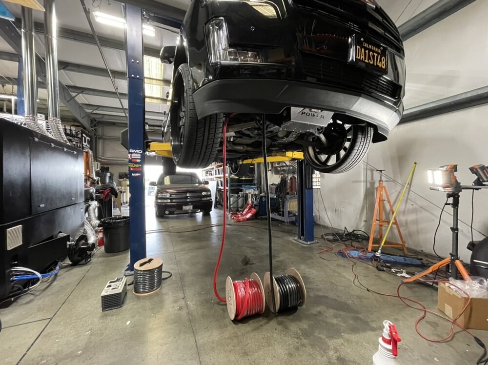

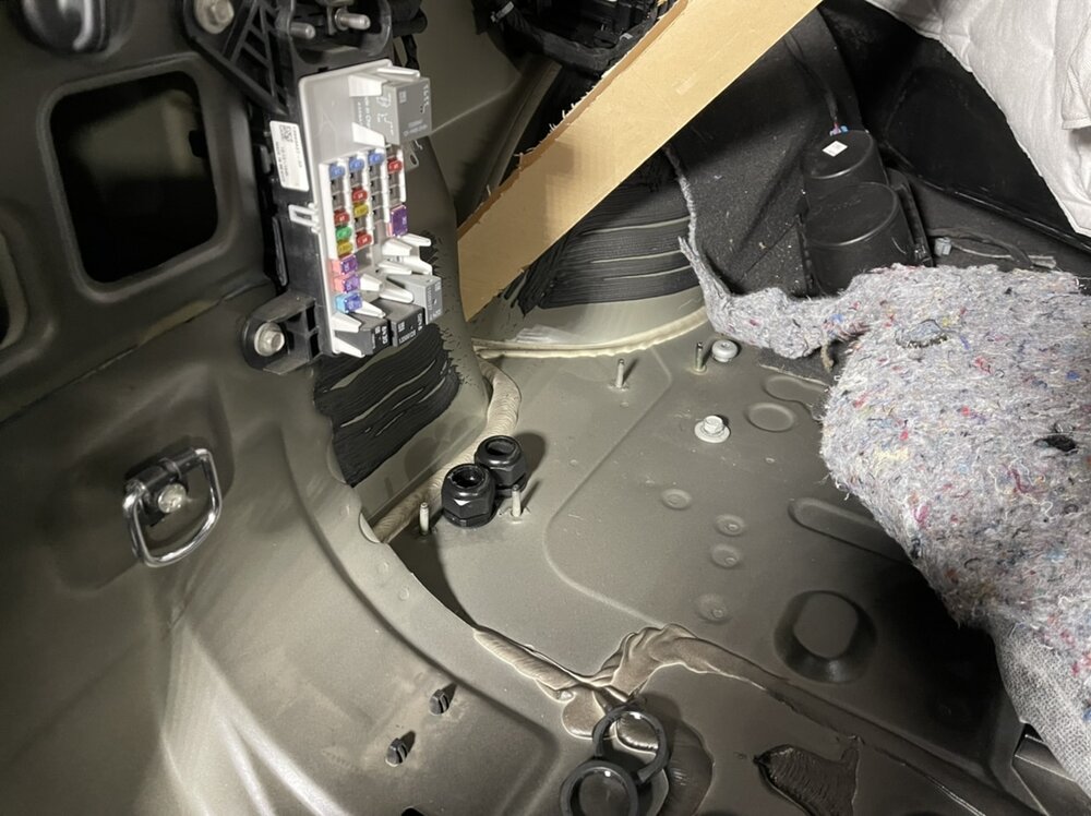

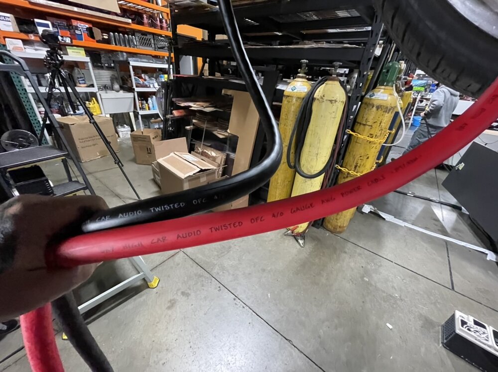

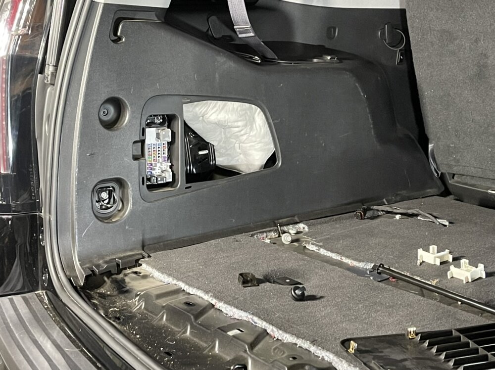

time to run some wire. I think ill pop in right here.
