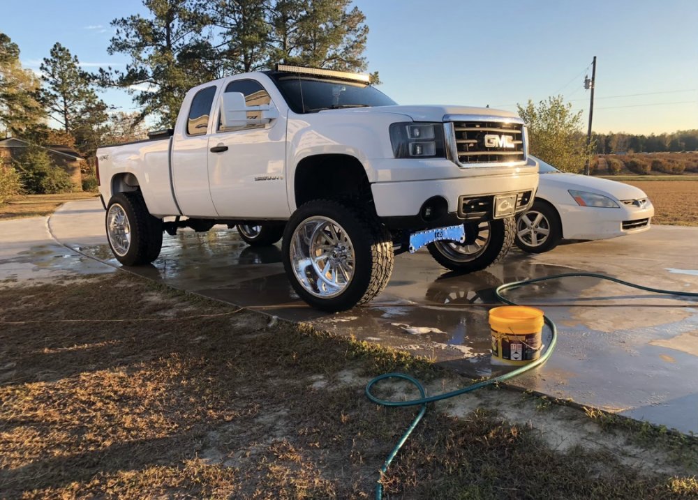

I have a 2007 GMC Sierra 4x4 with the 5.3 it’s got about 9” of lift with 37s on 24s. With a few 15s inside

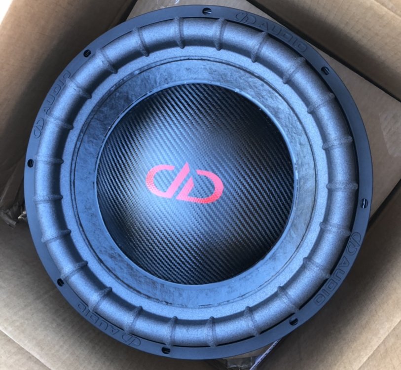

I have 4 digital designs 3515s with the Esp package wired to 1 ohm  on a m3c

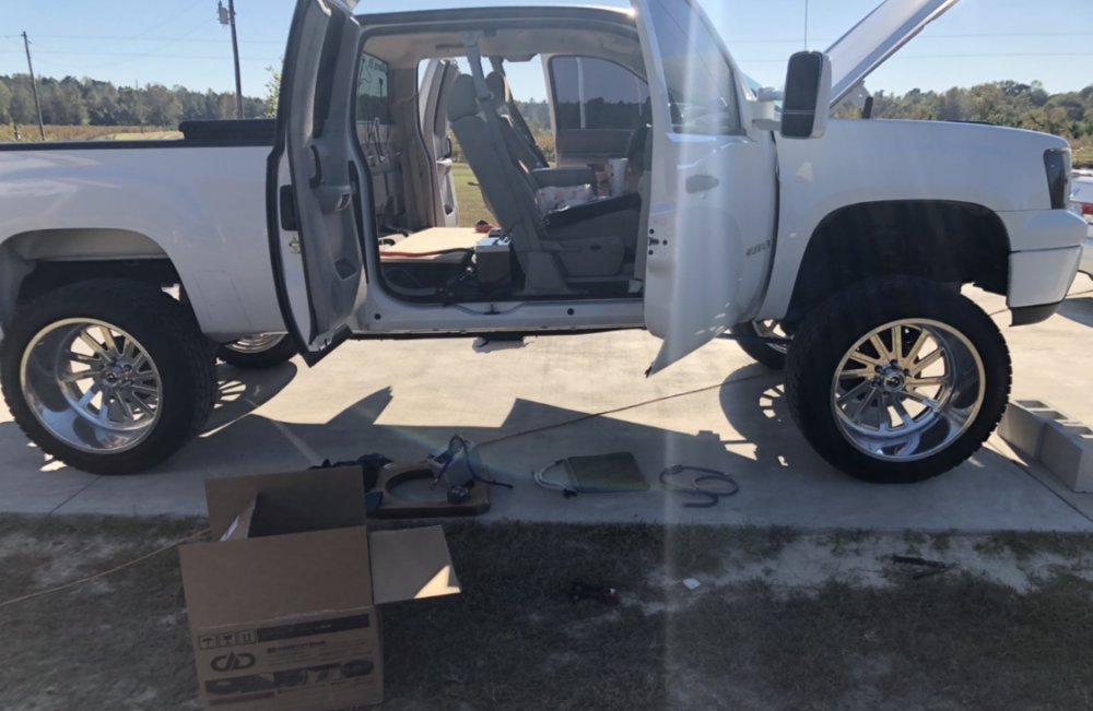

Heres a pic after I took out the backseat but before the box.

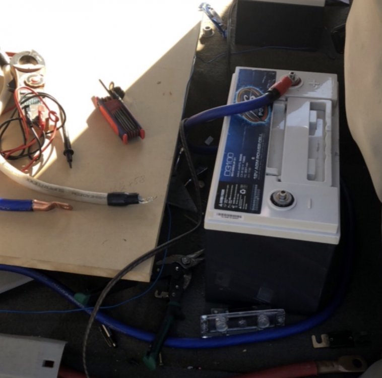

For batteries at this point I had a Duracell battery for the starter a d3100 d925 and a xp950.I’m using 1/0 ofc only one power run to the back and one ground to the frame .fot the alternator I have a 240 amp mechman

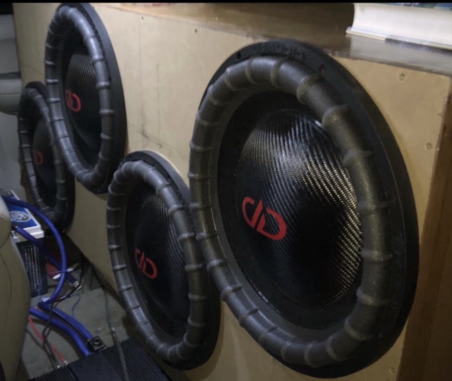

the box I had a guy I know build it for me it’s around 13 cubes tuned to 35hz it’s a pretty simple box it’s fiberglassed has dowels in the port and 2 metal bars I’m probably gonna vinyl wrap it eventually
after a few weeks I took it to my first show ruckus and chill and got a 146.4 on 7xx Watts at 50Hz hoping to get some more power at this point I was having some alternator problems and only running 3 of the 4 xs batteries I had so I should be able to make a little bit more power but I’m considering wiring at .25 just for burps any advice on this would be appreciated.
