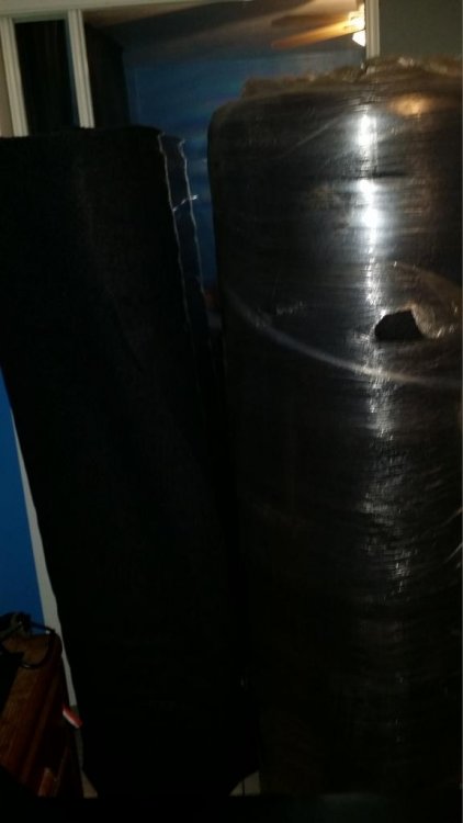

Ive used this a few times, its alright, but I personally don't care for it. https://www.parts-express.com/speaker-cabinet-carpet-jet-black-yard-54-wide--260-768
The reason these 2 linked below cost more for less carpet is because they are "backed" So they will be slightly stronger against abuse however be aware that the carpet will not stretch no where near as good, nor will it form into tight spaces and gaps.
So if your carpeting a box and use carpet seams (like I do) this is the wrong carpet to use!
https://www.parts-express.com/duralock-backed-speaker-cabinet-carpet-black-yard-48-wide--260-762
 https://www.parts-express.com/duralock-backed-speaker-cabinet-carpet-charcoal-yard-48-wide--260-764
So if anything, use the 54 inch wide stuff that is NOT backed, unless there is some reason that you really need it backed, but it will be a pita to work with.
I need to order a couple new rolls soon, really loving the stuff Im currently using, but I need to find the label to figure out where it came from and order it if its not too insanely expensive.
