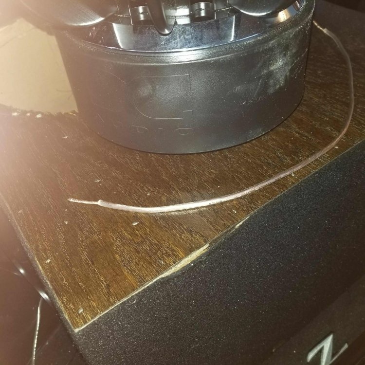

tmoney09 Posted February 17, 2018 Author Report Posted February 17, 2018 So I just thought of this..in the picture you can see the wire running from the speaker terminals..I don't recall what gauge it is but I have a smaller wire than that going to the speaker terminals..when I get a chance I'll pull the sub out and snap a pic of the wires that are connected to the sub but I'm thinking maybe they are too small and the sub isn't liking it..it was some bs wire from Wal-Mart I bought on the fly..I think it's copper too
tmoney09 Posted February 17, 2018 Author Report Posted February 17, 2018 Raptor 12 gauge is what I'm using to the sub terminals

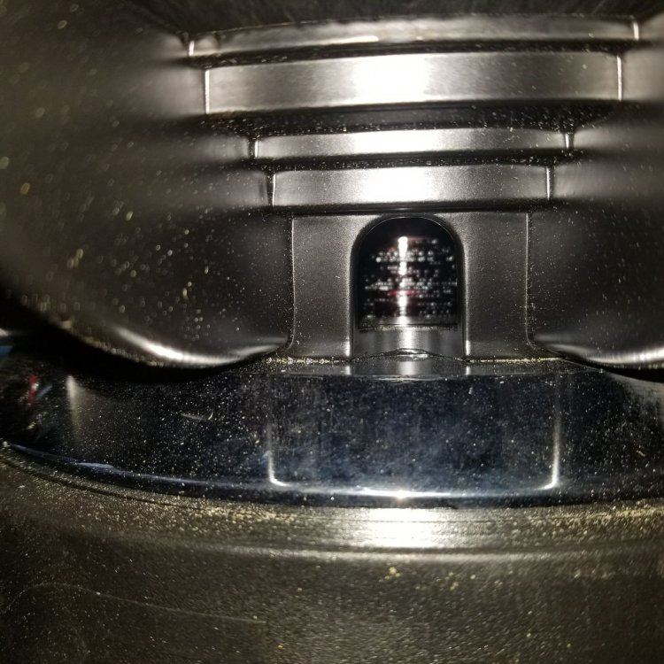

tmoney09 Posted February 17, 2018 Author Report Posted February 17, 2018 The coils were already dark like this when it was brand new..So idk how to judge if the coil is being burnt or overheated..idk if them being glossy is a sign of anything
audiofanaticz Posted February 17, 2018 Report Posted February 17, 2018 The color of the coil means nothing really. I have brand new coils laying around that never been put in a woofer let alone ever seen power that are pure black. Its the color of the coatings on the voice coil wire, those coatings keeps the wires from not making contact with each other, and is also bonding them together on the voice coil former. These coatings will differ in color from one another for a few different reasons, such as the type of product, how long it was baked for on the wire, etc. Plus those are aluminum wire voice coils, so the whole copper wire vs dark color theory people use can be thrown out the window. 12awg wire wouldnt make it stink. but you are on the boarderline of it. 12awg is good for about 1900 watts, however that is at a 100ish foot piece, so a piece of 12 gauge that is only a few feet long is not really going to be an issue, but Id probably still use 10awg.

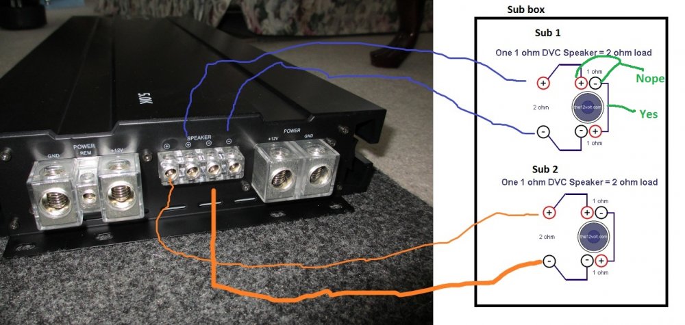

moh.vze.com Posted February 18, 2018 Report Posted February 18, 2018 You should take a picture of how you have it wired up. For instance, one of my buddies wired his sub wrong by connecting his positive to the wrong negative terminal on the sub. See example picture: DC Audio - Singer Alternators - Knukonceptz - XS Power - Hybrid Audio - Rockford Fosgate - Second Skin Audio - SMD - Sundown Audio - Elemental Designs
