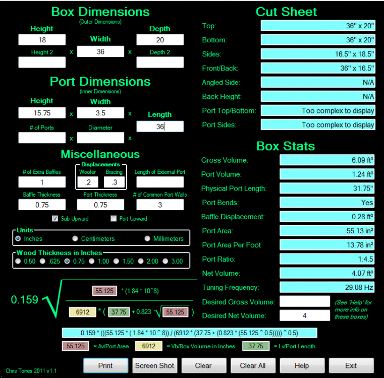

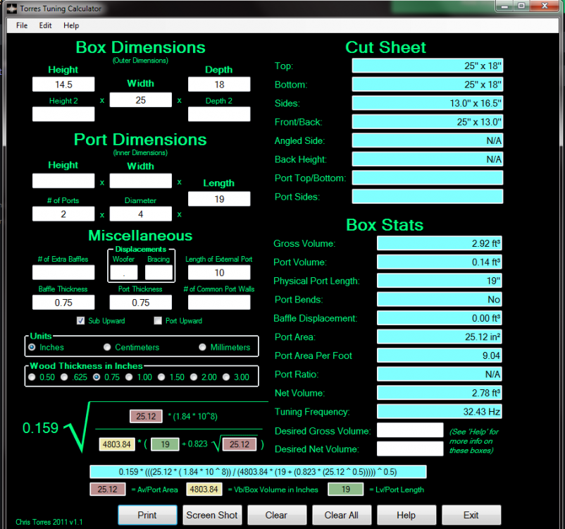

So I am debating on building a new box for my VCW 15. I am currently rolling a Kia Sedona minivan with this sub in a makeshift CRX style box(2.8 cube) and a JBL GTX500 amp powering at 2ohm..the sub is top mounted with the magnet/basket out and 2-4" pvc pipes firing towards the rear passenger side corner..I flared out the ports with a heat gun hoping for better low end (thinking that would reduce velocity) but i'm still not getting what i need below 30hz (my port sq in/cu ft is still pretty low, i know)..i've been playing with the numbers via Bassbox Pro 6 and Torres, and although making the box bigger (~3.5 cube) with a much bigger slot port gives better results in BBP6, i am torn between grabbing 2 sheets of mdf  for a better ported(laying out the cuts on Sketchup dictates the second sheet) or scrapping the ported idea and either going with a massive T-line or even a Parallel-tuned 6th order (which models quite nice in BBP6, although the group delay plots arent what i would like :) My musical taste is all over the place, but i like rock metal hiphop (slowed music too) and reggae. Here is a screenshot of my present box stats:
Normally I'm the port area police, but on the amount of power you are running your two 4" port are probably fine for port area.
If you are looking to get more output below 30 hz, you should probably tune below 30 Hz.  Increasing your box size would help too.  Something like 4 cu ft tuned to 28 Hz would work well, though with the larger net volume I'd suggest adding more port area as well.

I'm gonna follow your lead on this one, Triticum... looks like big ported tuned lower is the way to go.. I plotted out everything again at 4 cubes tuned around 29 and it looks like I should definitely benefit from it..i will probably add a little to the torres port length as i see a 5 inch discrepancy between the 2 apps...i might have plugged in something wrong on BBP 6, who knows...I factored in a 47HZ corner frequency for the van for the graphs (haven't tested it though I'm sure the bigger cabin of my van is gonna peak lower than say, a mid sized SUV)

Looks good to me.  The port length in BBP seems really long to me though.  Generally Torres will tune you a bit on the low side as well.
Based on my calcs, a 4 cu ft box, with a 3.5 x 15.75 port, the port will need to be about 31" long to tune to 29 Hz.

OP you should consider that bassbox pro does not support slot ports, just square or rectangular non slotted ports. Can't compare results with Torres when using a slot ported box, on the top of that Torres miscalculates a slot port displacement altering tuning as a consequence,  so it's a really useless comparison.
Yep just ran through the numbers again and you are spot on! I appreciate your input and am impressed with your builds ?

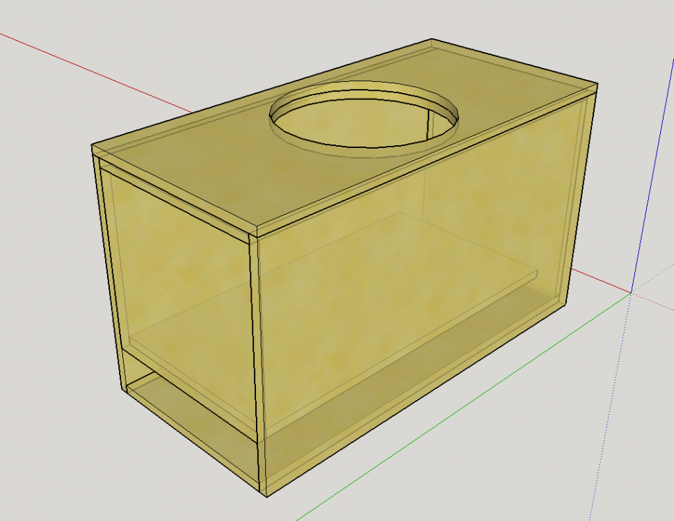

I wasn't aware before but I'm glad you brought that to my attention Joe...I sketched up a couple different box designs but torn between which arrangement will load off the rear corner better:
