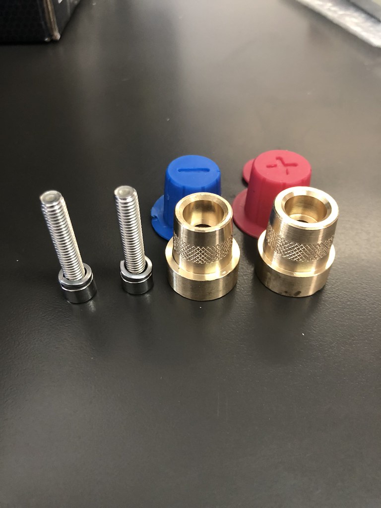

4/0 cable cutter $17 on Amazon great deal. Hammer crimper $22 also on Amazon ??
28187612248_b3e9c51030_b.jpg42031674881_0cf6f22351_b.jpg41311286594_780a7c04f3_b.jpg41311285904_f232cfc382_b.jpg41311289824_5c7c72bd66_b.jpg

Something id like to point out is the hammer crimper. Its hard to get a good solid connection with a hammer crimper. Id suggest a hydraulic crimper. You can get ones on ebay that come in a yellow box with yellow handle for around 40 bucks. Itll give you a nice cold weld that will never come loose. Other than that looks great and cant wait to see more.
was just going to suggest the same. Its well worth the money. Plus a little more versatile also. Good luck hammer crimping something in the engine bay.
