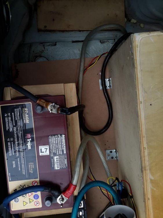

tomlintm Posted May 16, 2018 Author Report Share Posted May 16, 2018 (edited) i hope this helps you understand what is going on Edited May 16, 2018 by tomlintm Link to comment Share on other sites More sharing options...
tomlintm Posted May 16, 2018 Author Report Share Posted May 16, 2018 (edited) looks like im running ofc not cca cable Edited May 16, 2018 by tomlintm Link to comment Share on other sites More sharing options...
