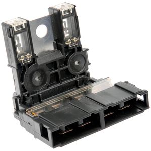

Joshdashef Posted May 29, 2018 Report Posted May 29, 2018 I'm pretty sure this is the part that connects to the terminal posts via a bolt is this; https://www.autozone.com/batteries-starting-and-charging/battery-fuse/dorman-battery-fuse/948548_0_0 And the connection made is only a nut and bolt that comes from something like this but with a nut not a wing nut; https://www.oreillyauto.com/detail/b/super-start-4986/battery-accessories-16452/battery-accessories-16508/battery-terminal---universal-17657/393e97768e9a/super-start-battery-terminal/08507/4742239/2008/honda/civic?pos=5 Now XS power batteries use a screw style instead of a post that is pictured above so the only options you have are like these so you can still use a post type connection instead of a screw through this adapter; (this would allow you to use your factory terminals) https://4xspower.com/shop/accessories/terminals/580-top-terminals/ Or if you are looking for more posts so you can have options they make these in two variants that fit your battery (https://4xspower.com/shop/12v-agm/d-series/d2700/) Variant 1 http://4xspower.com/shop/terminals/554-i-bar-marine-terminal-adaptor-with-516-and-38-studs-top-only/ Variant 2 http://4xspower.com/shop/terminals/556-i-bar-multi-top-post-terminal-adaptor-top-only/ Hope this helps SMD Tool Map (2024): https://www.stevemeadedesigns.com/board/topic/226545-smd-tool-map-2024/ Great Box Bracing Examples: https://www.stevemeadedesigns.com/board/topic/202148-best-way-to-brace-a-box/?do=findComment&comment=3055002
QXFiddySex Posted May 29, 2018 Author Report Posted May 29, 2018 Thank you @Joshdashef . I do believe that 556 i-bar adaptor is exactly what I need. I can not believe that I didn’t think of those.
