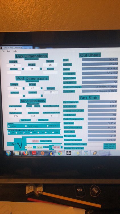

GorillaFIngeRs Posted June 24, 2018 Report Posted June 24, 2018 Just got my hands on a mint SP4 15" been running a 12" of the same sub so pretty excited to see what this thing can do with more cone area. I am putting this into a 2011 toyota corolla on an AQ3500.1 (4300rms). Max dimensions are 35wx17hx27.5d. I would like it to be smaller than that if possible but I do understand I may need to give up all of my room. If I could get some design help that would be cool. Not sure how much port area to shoot for but am pretty sure I should be shooting for around 14in sp/ft (open to suggestion), looking for some direction or some ideas if anyone has the time to help with a design that would be much appreciated. Also, I was told going sub up port to the side i would be the loudest. I have done some experimenting and have found that port to the back passenger side does seem to carry lower notes the best... fwiw. Thanks for any help or input. AQ3500.115" Fi SP41/0 Knuconceptz Power/Ground 1/0 Sky High Big 3 UpgradePioneer AVH-4200NEXXS Power D1200 Underhood Intimidator Gel In Trunk CES 250A Alternator

GorillaFIngeRs Posted June 25, 2018 Author Report Posted June 25, 2018 How about this here? Sub up AQ3500.115" Fi SP41/0 Knuconceptz Power/Ground 1/0 Sky High Big 3 UpgradePioneer AVH-4200NEXXS Power D1200 Underhood Intimidator Gel In Trunk CES 250A Alternator
DiBo Posted June 25, 2018 Report Posted June 25, 2018 59 minutes ago, GorillaFIngeRs said: How about this here? Sub up How do you get a 15.5" port in a 14" tall box? ?
GorillaFIngeRs Posted June 25, 2018 Author Report Posted June 25, 2018 haha, damnit. I was planning on 17 tall and didnt switch it up haha. AQ3500.115" Fi SP41/0 Knuconceptz Power/Ground 1/0 Sky High Big 3 UpgradePioneer AVH-4200NEXXS Power D1200 Underhood Intimidator Gel In Trunk CES 250A Alternator
DiBo Posted June 25, 2018 Report Posted June 25, 2018 1 hour ago, GorillaFIngeRs said: haha, damnit. I was planning on 17 tall and didnt switch it up haha. You might be on to something when you get them dimensions correct.
ckeeler11 Posted June 25, 2018 Report Posted June 25, 2018 You will also need some extra bracing so make sure to account for that.
shredder2 Posted June 25, 2018 Report Posted June 25, 2018 This is a SP4-15v2 design I did for a 4500 watt amp... Pretty much the minimum port area I'd use with the volume/tune and pretty much the same power as you've got, turned out to be around 16in2^ft3. I added a 1.5" dowel front to rear and some 1"x14"x.75" strips to the sides to brace but it only changed volume .034ft3 so the tuning was about the same. IDK what you can get realistically volume wise in your space but on your power I'd look for 16in2^ft3 minimum if you're around 4ft3-4.25ish net IMO, that's a pretty capable driver... even the v1. Nice badazz sub IMO.
GorillaFIngeRs Posted July 6, 2018 Author Report Posted July 6, 2018 Decided to tune lower. Worked with a buddy on design. Throwing this out to see what you guys think. Gonna start build this weekend, cant wait to hear this damn thing. Thanks for all the input so far. AQ3500.115" Fi SP41/0 Knuconceptz Power/Ground 1/0 Sky High Big 3 UpgradePioneer AVH-4200NEXXS Power D1200 Underhood Intimidator Gel In Trunk CES 250A Alternator
