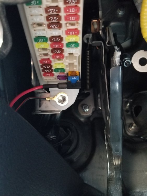

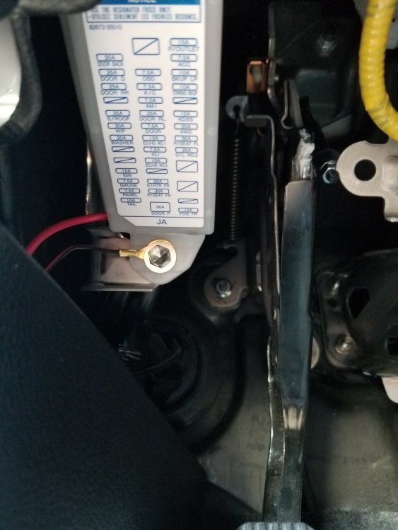

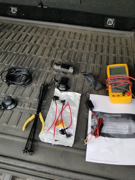

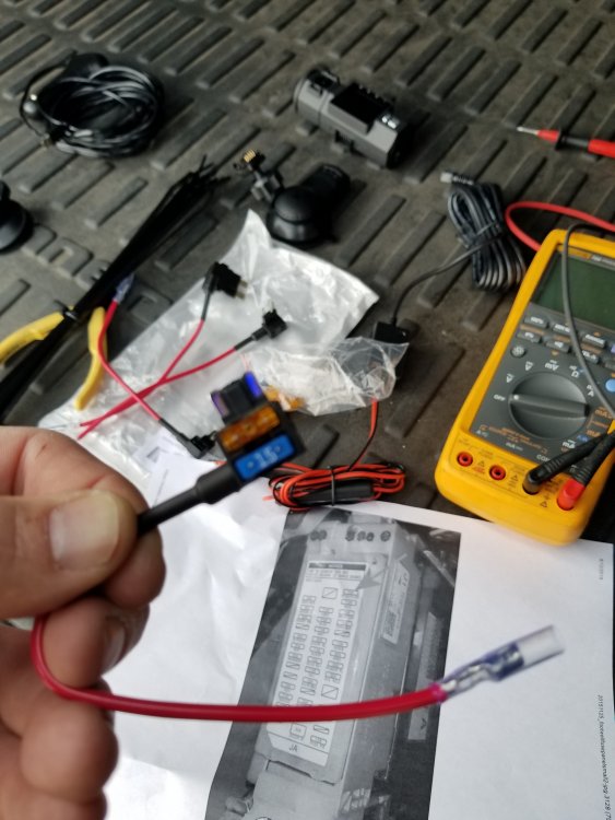

GPS mount add on, and hard wire kit, for 24hr shiz.....
24 hour kit, was a china made thing, but, hell, it was wicked cheap, came with several different fuse box attachments, long enought wire (way to fucking long even, in my case) and everything you need to hard wire it rig. On the left, is the old cable/power cig lighter power supply, and suction cup mount. On the right, the kit, new mount, camera, and meter to find constant.  Took me, about 10 mins, and it was all done, set up and rolling.
20180812_121739.thumb.jpg.c3ab49481447cfab2782f74788a113a6.jpg20180812_122628.thumb.jpg.ed9bf61e3254f3be2a661a63c54a7ab8.jpg
 Set the VANTUREs GPS shit, which was cake, parking mode feature to ON, set up the "G SHOCK" setting. (i set it at high initially, but, christ, a leaf on my tree would move, and it would start recording lol. Was recording like, every 20 seconds of ,.... well, a leaf moving, so i set that to MEDIUM) . Turned out fine.  I park backwards out my pad, and i can see my entire front yard, property line, to property line. Kinda cool. I have 2 out door cams, but, this is kinda cool to add in the mix.
and,.. bob's your uncle...
20180812_125803.thumb.jpg.74888ee64ffeb0ec53ee44fa254490ca.jpg20180812_125852.thumb.jpg.f420b9bf1113bb3684c3ff37f9ff6458.jpg
