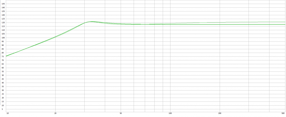

Hellbilly429 Posted July 11, 2018 Report Posted July 11, 2018 If you want to go Optima, get the Yellow Tops (CCA's not as important as Ah's). You want to be around 13's (if possible) to get the most out of any amplifier. Watts = Volts X Amps. In a low voltage system (i.e. car electrical systems) voltage dropping is more concerning than in a higher voltage system (i.e. home audio) as it has a much bigger effect on the amplifier's ability to output wattage. As for boxes, the X 12's can work in a 2 cubic foot box, it is just more optimal to run in a 2.5 cubic foot box as the suspension is designed to handle the extra air space, and more airspace makes for easier low end extension. Given that you are planning on throwing over the rated RMS at the sub, it would do just fine in a 2 cubic foot box, and would help protect it from over excursion given the extra power. Dark green is the X in a 2 cubic foot box, light green the U series in a 2 cubic foot box, both with 2,000 watts applied and 32 hz tuning. Reach out to JP at Down4Sound and he will give you opinions on both subs, prices on their custom subwoofer boxes (they build sick looking boxes!), and sell you the sub you decide to go with. 2018 Honda Civic Sport Hatchback (build in progress) NVX Sound Deadener (Front Doors) Stinger FAST Rings Stock Electrical SSA Evil 6.5's Front Speakers Stock rear speakers MB Quart ONX4.80 speaker amp Rockford Fosgate T-1500bdcp DC Level 4 12" D1 @ 2-ohm Box In Design Stage Stock RadioMy Build Log
