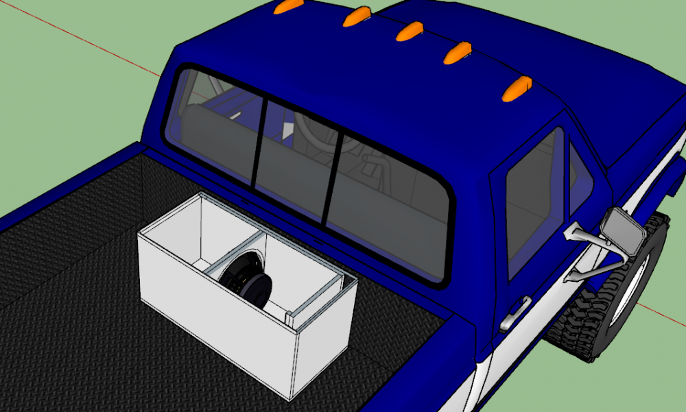

SnowDrifter Posted July 14, 2018 Report Posted July 14, 2018 Also could you post a sketch or diagram of how everything is laid out? ~~~~~~~~SAY NO TO PHOTOBUCKET~~~~~~~~ Snow's DD-1 tracks here: https://www.stevemeadedesigns.com/board/topic/167433-snows-dd-1-tracks/ My take on OFC vs CCA: https://www.stevemeadedesigns.com/board/topic/110381-things-that-piss-you-off-in-the-car-audio-world/?do=findComment&comment=2461444

nickcamarata Posted July 14, 2018 Author Report Posted July 14, 2018 drew up a quick sketch in sketchup
nickcamarata Posted July 14, 2018 Author Report Posted July 14, 2018 theres about a 1 inch gap between the port and the sheet metal of the bed
