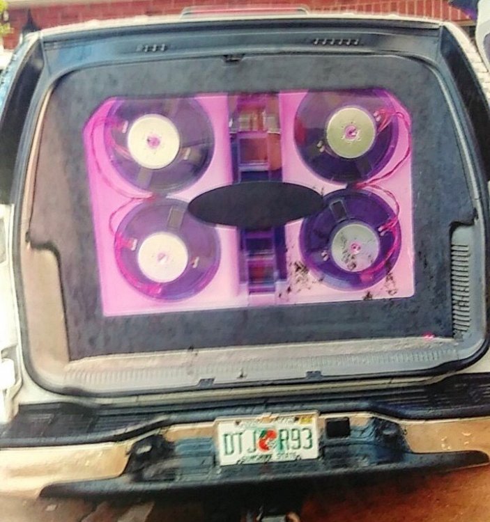

I have been out of the audio world for a few years, but I picked up a 4th order box off facebook recently that was built specifically for my 2001 Chevy Tahoe. Got it with all the trim pieces for $150.. I couldn't pass it up. I have attached a few photos if anyone is curious to see what it looks like, they arent the best but you'll get the idea.

Just got home and measured the box, it’s built in a 2:1 ratio, 2cubes per sub on the sealed side, 4 cubes per sub on the ported. For 24 cubes total after port area but before sub displacement.

That's a nice enclosure. 4x Sundown X15's.... Slappin
