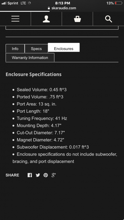

So I’ll start off saying I used to have subs when I was younger about 10 years ago. Fast forward now and I’m married and have workshop now and love to build stuff. Well searching YouTube I saw a guy built sub box for his Silverado so I thought hey why not. So this has all been new to me because in the past I just had an audio shop hook all my stuff up. So I built a sealed box for my truck. Extended cab 99 Silverado. It has 2 8” skar ix8s dual 4 ohm. And I have a boss 1500 mono. Yes I have recently watched YouTube showing how little power this amp actual puts out so I’m in the process of getting a new amp. I’ve calculated I’m prolly only pushing 46 watts to each sub. They are 150 Rms a piece. My box originally had .60-.65 space for each sub, it was a sealed box, which is what the specs call for. So I’ve recently decided to add ports to the box. I’ve added the pvc and built the small kick outs u can see. I’m looking for help checking to see if I did it right.
Each space is roughly 20x10x8 = 1600/ 1728 = .92
i have 4 Inch pvc pipe going into each space total length of each pipe is 18 inches  that includes a 4 inch 90  I have the pipe straight back then 90d to go behind the subwoofer on the back wall  the pipe is about 2 inches away from wall and the magnet on the woofer. I really didn’t know how to calculate pipe so I just took 4x4x18 = 288 - 1600 / 1728 = .76 which is almost right dead on what skar calls for in a porter box. I think I may be calculating pipe wrong. Now I didn’t factor in my sub woofer displacement but it’s so small didn’t think it mattered. Does this seam right? I don’t feel a ton of air moving in and out of port but I know the subwoofer is getting 1/3 if it’s power to it. Is it ok to run the pvc pipe right behind the subwoofer? When the bass hits it sound like the sub it hitting really hard against the box wall  like a hollow wood sound  it’s not bad I’m just not used to hearing that  this is the first ported box I’ve used or built

20x10x8 of gross  internal airspace with a port which is 4"x 18" results in 0.75@46Hz, port area of 12.6 square inches. Hope you don't like rap (and such) or even try to play it on higher power on those boxes.
Joe. I looks like I’m not to far off on my numbers.
.75 — .75
41 — 46hz
13in port — 12.6in port
the sub is listed .41 I’m at 46hz. Is 5hz a lot? Or is this sub not good for rap music? I believe I’ve heard low 30s is good for rap. If true how could I get the box to that?
