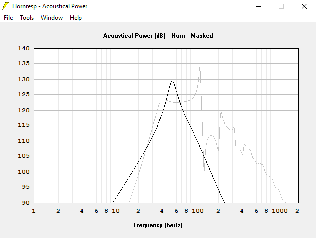

Triticum Agricolam Posted October 9, 2018 Report Posted October 9, 2018 On 10/5/2018 at 8:41 AM, vnisme said: The 4th bp now is 1.4 sealed. And ~2.7 ported. 6 in roundport, 6.75 long. Calculators say it should be tuned at 53. Do you think the tuning is fine on the quarter wave horn? Or do you believe it should be more around the fs of the sub? Sorry it took me a couple days to get back to you. Here is a comparison of the T-line vs your bandpass box: The black line is the bandpass box, the grey line is the T-line. The bandpass box has a higher peak output around its tuning frequency, but the t-line has a much larger and smoother bandwidth. "Nothing prevents people from knowing the truth more than the belief they already know it.""Making bass is easy, making music is the hard part."Builds:

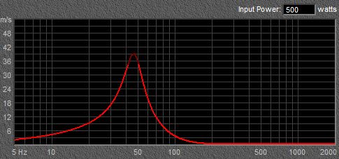

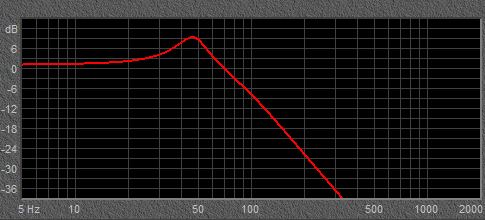

Joe X Posted October 9, 2018 Report Posted October 9, 2018 Here's what I have for your 4th order BP: 1.4 rear, 2.7 net @ 49 Hz front, 28.3 sqin port area. This should be the same as the above plot but with cabin gain (generic) added: I did find your port tuning is 49Hz as calculated with this software. What seems to be a big problem is your port area: * power shown is per driver. It looks like you should have way more port area to get proper output with this enclosure. I will recheck my data later to be sure.
