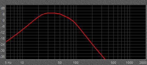

Joe X Posted October 20, 2018 Report Posted October 20, 2018 That's small here's how the subs would perform inside a vehicle in a 6th PTBP specs Rear:2 net @ 27Hz, Front: 1 net @ 57Hz, Id say 30-55 the following looks good:
vnisme Posted October 20, 2018 Author Report Posted October 20, 2018 so you recommend the tuning at 30 and 55? it does look better. how much port area do you recommend for the rear and front?
Joe X Posted October 20, 2018 Report Posted October 20, 2018 No I was checking the projected frequency response on the plot above you see 30-55 seem pretty even but the tuning frequencies are what you chose the plot above is for the spec given which is Rear:2 net @ 27Hz, Front: 1 net @ 57Hz, you can modify this spec as you see fit, when you land in a desired spec and power I will give you ports areas.
vnisme Posted October 20, 2018 Author Report Posted October 20, 2018 I'm going to go with Rear: 2 cu ft @ 30hz and, Front: 1 cu ft @ 59. Comparing the two graphs, i could be wrong but the bandwidth is almost as wide as the t-line/horn right? My graph on WinISD shows it is close up till 70hz, which i dont think i listen to 70hz+. This will be going on a pioneer gmd-9601, so ~1000 watts? What if I wanted to do 2000 watts in the future?
