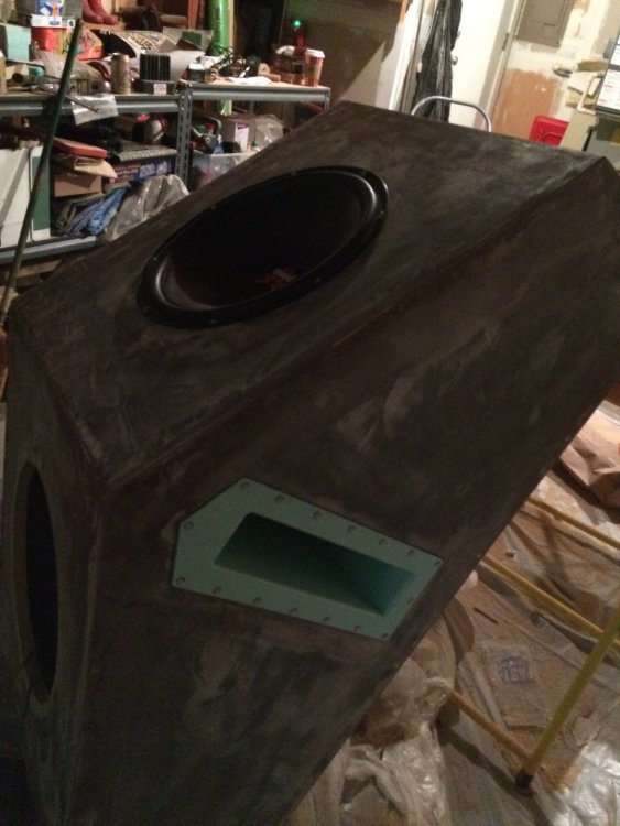

Bret Posted November 26, 2018 Author Report Posted November 26, 2018 Here she is. When I put the speakers in I noticed the surrounds were coming apart in several places. I just reconed these with oem parts. Guess I should have used some other surrounds.

Bret Posted November 26, 2018 Author Report Posted November 26, 2018 3" w x 12.75" h x 8" l Hopefully tuned to 30hz. Ill see once I get some new surrounds and can play them.
Bret Posted December 5, 2018 Author Report Posted December 5, 2018 Got the the surrounds last week and glued them on. Wired this up and am breaking it in. I'm really happy with the sound of it. I haven't cranked it up yet but at low volume it hits the lows like I was hoping. The tuning turned out to be what I was shooting for at 30hz. It will play below 25hz so I think I need to crank the subsonic filter up a bit. I tried painting it a few times and ended up covering it with foam core wrapped in vinyl. It worked OK but I'm totally disappointed with the 3m spray adhesive. I went through 2 cans ($20) and tried thin and thick applications and didn't get it to stick as well as I expected. I wouldn't use it again. Any spray or brush on adhesive recommendations?
