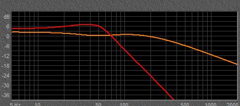

Here's a SWR 12D4 sub in sealed 1 net (orange) and in a 4th BP rear:1.4 net, front: 1 net @ 48 Hz (red):
A 4th BP setup like that would be like a super sealed, acting close to sealed but more efficient,
