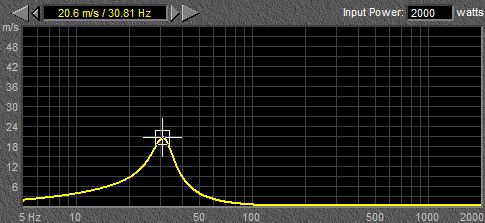

I have box specs  from your dimensions of 2.5 net @ 33.6 Hz 41.4 square inches of port area, 1" wood, port area came out good with my software:
Zv5 12", 2.5 net @ 32Hz, 41.4 square inches of port area, 2000W RMS :

So your box will work well as it stands, is just that I have a little time to answer the question, if using 3/4" birch then your port area is 54.4 square inches, did the following to figure your box specs (some minor assumptions were made) :
From the chamber base area shown in light blue you can figure gross volume, subtracting the sub and cross brace displacements  you arrive to 2.8 net @ 33.2 Hz, 54.4 square inches of port area.
On the port area, no much more than what Sundown suggests is needed if you keep to rated power of 2K, about the 21 m/s of peak airspeed @ 2000 W for the 41.4 sqin you gave last time, only if you were to run 3000 W you would need that much port area, and you would still be at about 23 m/s with the 54.4 square inches, so how extra port area affects you? Mainly a heavier and bigger box, only if you port were too long you would have to deal with port resonances (yours is not) .
