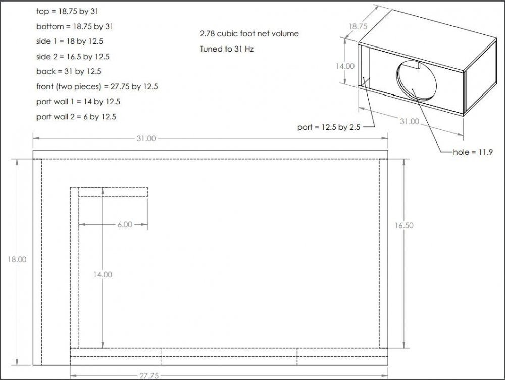

The second design (2.78ft3 @ 31hz) was designed by JL audio customer support.

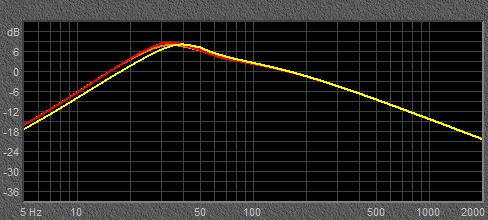

So you have three designs you are considering,  I call them design A (2.49 cu ft @ 30 Hz), B (2.78 cu ft @ 31 Hz) & C (2.375 cu ft @ 34.6 Hz).  The first thing you need to realize is there isn't going to be much difference in performance between the three.  Design A and B are so close that they will be completely indistinguishable from each other.  Design C has a little higher tuning, so you will get a bit more output around 40 - 50 Hz and a bit less below 40 hz, but we are only talking about 2 dB of output difference, which is only barely going to be noticeable, if its noticeable at all.  Here is a graph of the raw output of these three boxes so you can see what I'm talking about:
Design A is the green line, design B is the yellow line, and design C is the orange line.  I included your 50 hz 24 db low pass filter in the graphs.  Please note that cabin gain is going to boost the low frequency output of all of these enclosures significantly when they are in your vehicle so the actually frequency response you are going to get is going to be significantly different than what's shown here.  Cabin gain is somewhat unpredictable so its difficult to simulate it in software, however the graphs should accurately show the relative differences (or lack there of) in output between the different designs.  As you can see there aren't a lot of difference in the graphs.  Since you want good output down to below 30 Hz, I don't think design C is going to be what you want.  Between design A and design B, its not going to matter which one you pick.

Here are the same plots as above using generic cabin gain to illustrate the low end boost of in- car performance:

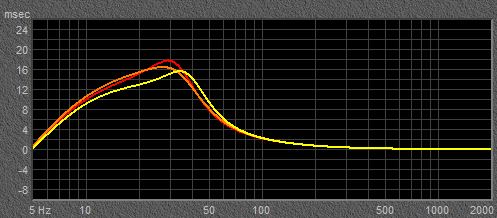

Here's group delay (related  to sound quality) for the 3 designs, it's low enough on all designs so this should not be an issue, JL's reference design (in yellow) still gets lower than the alternatives:

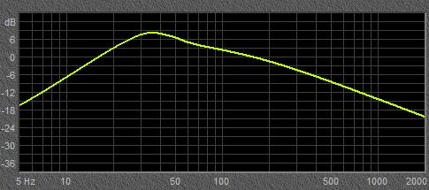

Here's D also : 2.5 @ 32Hz just to show there's life beyond A, B; or C :
Here's group delay (related  to sound quality) for the 3 designs, it's low enough on all designs so this should not be an issue, JL's reference design still is lower than the alternatives:
Thank you Joe. In regards to your group delay post (I am unfamiliar with this term), which box would you recommend? I see above you say this is not an issue, but being an avid percussionist I very much want everything to be "in time" as much as possible. It looks like the red line box is the worst of the bunch in that regard, which box is that?
Also, you speak of life beyond A, B, or C, I'd be very interested if you had a box recommendation or design you would be interested in sharing with me or which of the 3 boxes you would personally pick if you had "my sound preferences".

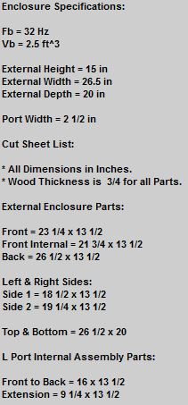

So here is option "D" as in the plot I left you above and within your max dimensions, power: to sub rated, amp subsonic filter to 27Hz, minimum port clearance 2 1/2", figure is just an assembly guide:
NOTE: If building outside you need to build a cardboard dummy box to test fit in it's way inside.
Group delay will be as in the orange curve above if you are curious to know.
