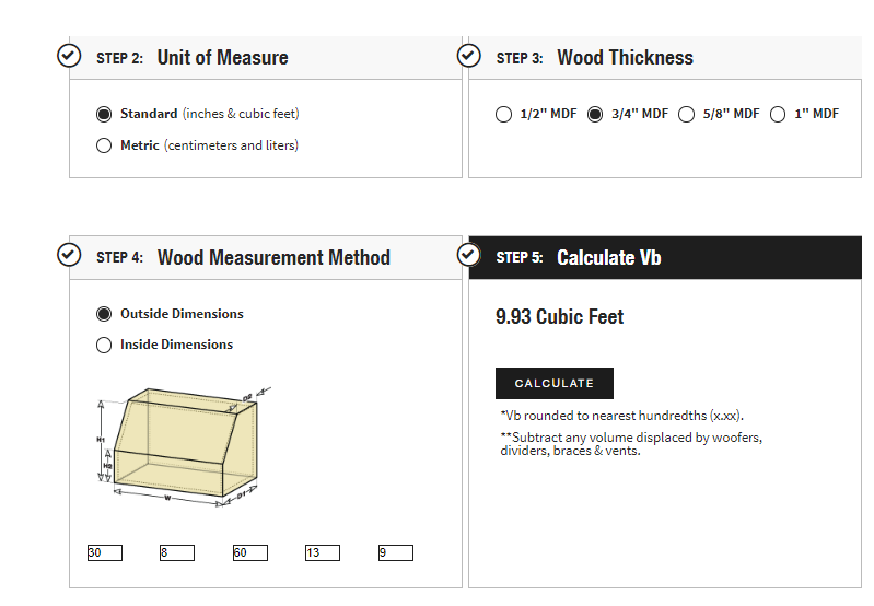

thefatkid Posted January 15, 2019 Author Report Posted January 15, 2019 yeah im running that now with no complaints really, good thing is the sundowns only need one cube each so id gain some seat room back that i havent had which is always nice.
ckeeler11 Posted January 16, 2019 Report Posted January 16, 2019 22 hours ago, thefatkid said: i can actually do 4 12s ported to their recommendations. 4 10s would save me some seat space but 12s are doable. i have about 8 cubes available before accounting for subs, ports, bracing. 8 cubes is not enough. .5 a cube is sub displacement, another .5 to .75 for port displacement, and then bracing will be at least .25 so that leaves you at 6.75 CU. FT which is below their recommended 7 cubes, which is probably a little on the low side anyway. I say go with 4x10's and good luck!
thefatkid Posted January 16, 2019 Author Report Posted January 16, 2019 thats what i have available, but the tens give me seat space back due to the physical size as that is my mounting surface. but i have 8 available based on this
