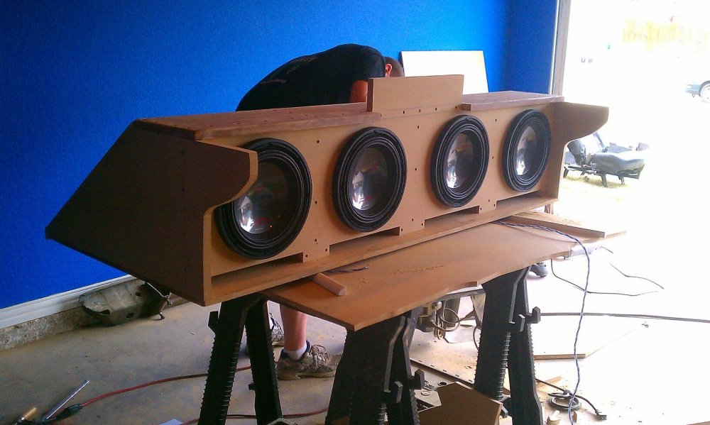

thefatkid Posted January 14, 2019 Report Posted January 14, 2019 hi fellas, fng here. i have a 2008 ram single cab. i currently am running 4 alpine type r 10s ported downfire. after 6 years of beating ive finally blown one. so time to redo anyway right. ive been looking at some different brand subs, skar vvx-10s are catching my eye right now. reason for posting is that ive gotten so many different opinions on everything in the world. some saying to not build a box to the sub specs, some saying to use the DDbox design measurements and not do what he sub is asking for. got other saying this brand vs that is complete trash. (which i expected obviously) all in all, i was not disappointed in my alpines performance for the time i had them but redoing the whole interior and setup i don't want to do all this work and have less output. off of some rough measurements i think i have 8 cubes with 3/4 mdf available. what subs would you consider for 4 10s or 2 12s on a kind of budget setup. i have about 600 bucks for subs max. and i have about 1800 watts available at 1 ohm. any help is appreciated. sorry if i violate any rules. pics attached are of current setup. thanks again, Josh
ckeeler11 Posted January 15, 2019 Report Posted January 15, 2019 4 10's will have more cone area than 2x12's, so they have the potential to be louder. Looks like the box is ported? what are the specs of the box (tuning, port area, volume)? Most likely you will want to build a new box matched to the sub specs.
thefatkid Posted January 15, 2019 Author Report Posted January 15, 2019 yes sir planning on a new box and console, all that has been in tehre for 6-7 years. im getting conflicting advise on how to do the box and what to tune to. i know i want ported, i know i have 8 cubes before subs and bracing and ports.
