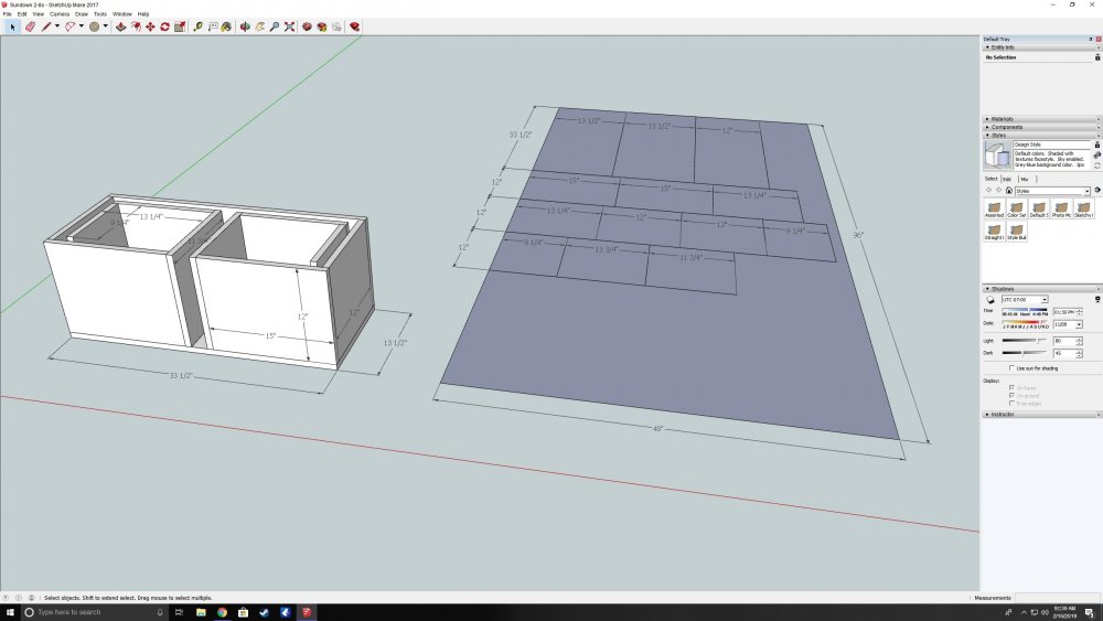

rated power to subs, 35hz tune (roughly)
That design looks very nice.. about how many cubs per sub is this and what tuning?
Looks like the Sundown Sketchup design to me Op
If it is it's linked on their site.
Id wager its close to their recommendations.
That space available you supplied seems smallish to me at a glance, you might end-up using closer to minimum airspace even with a round port.
A slot uses more volume and those measurements seem small to me
I'd try to find more space if using a slot... of course it's gotta fit thru the opening so even tho the space is available I'd make sure it'll go in there
That’s also why I listed those specs due to the opening of the trunk. Is it possible you can design one with aero ports instead?
