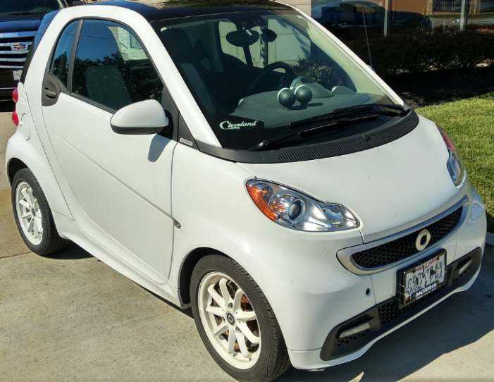

Anyways, here's my car. ...cool, right?
PicsArt_07-18-05_19.45-1048x810-723x559-701x542.png.f67af5c79cf365708ef269a773724121.png
Pics of stock locations would be nice to start giving advice.
