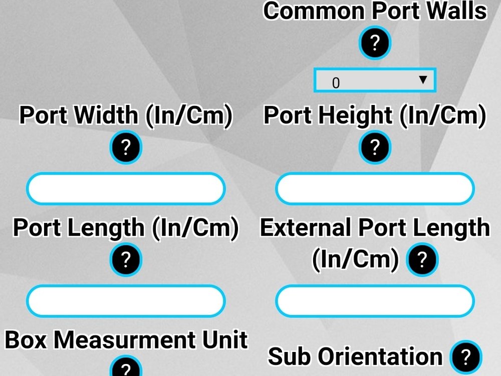

So how exactly do I figure all that up to come up with a slot port idea so can compare the 2?
Slot port is gonna be the cheapest lol just have to figure out how to do better then my first attempt...
Slot ports are easy... You could do 4.75Hx30L... 142.5in² for port area and length determines tuning. It's really simple and pretty spot on. Run that across the bottom and plug in 1 common port wall as the bottom of the enclosure is the only side that the face of the port touches. Bada bing bada boom. Done. Properly tuned. Should be around 24in long or so

So how would I turn that into a cut sheet to make a box?
I assume its right lol
Displacements is in ft³ so 1 doesn't work. When I put these measurements in I got 10.51 before bracing tuned to 31.62 with around 13.70 in Port area and a 1:4.00 port ratio. Shrink the enclosure down just a tad and brace well for ¾" material. Port sz looks good.
Was gonna try and put this into re box calculator to try and make a cut sheet but my computer is toast :(
Pencil and paper always works. Not being a smart ass.
