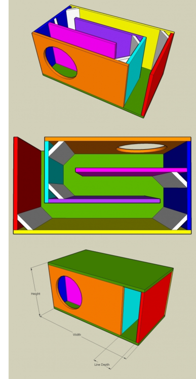

Kinyo85 Posted March 25, 2019 Report Posted March 25, 2019 my first time with a t line and just wont to know if this looks right it for a Sundown Audio E 10 V3 D4
Triticum Agricolam Posted March 25, 2019 Report Posted March 25, 2019 How much power are you going to be running? Reducing the line area can often be beneficial. "Nothing prevents people from knowing the truth more than the belief they already know it.""Making bass is easy, making music is the hard part."Builds:
Kinyo85 Posted March 25, 2019 Author Report Posted March 25, 2019 I am probably going to run 450 watts off the 5th channel of a NVX JAD900.5
Kinyo85 Posted March 26, 2019 Author Report Posted March 26, 2019 I made the line area a bit smaller is this better or shuld i go with my first plan I will have to run a spacer for the sub to fit
Triticum Agricolam Posted March 26, 2019 Report Posted March 26, 2019 1 hour ago, Kinyo85 said: I made the line area a bit smaller is this better or shuld i go with my first plan I will have to run a spacer for the sub to fit That should work well with the power you have on tap. A couple things to keep in mind, your output is going to roll off once you get much below 40 Hz. Also be sure to set your subsonic filter to around 30 Hz if you have one, otherwise you run the risk of damaging your sub. "Nothing prevents people from knowing the truth more than the belief they already know it.""Making bass is easy, making music is the hard part."Builds:
Kinyo85 Posted March 26, 2019 Author Report Posted March 26, 2019 how would I make it go below 40 Hz and will this box be ok for all types of music with a nice bass output it will be going in a 2014 Toyota corolla
Triticum Agricolam Posted March 26, 2019 Report Posted March 26, 2019 To get the enclosure to play lower you need to tune it lower/make the line longer. If it were me I'd shoot for about a 32 Hz tuning. "Nothing prevents people from knowing the truth more than the belief they already know it.""Making bass is easy, making music is the hard part."Builds:
Kinyo85 Posted March 26, 2019 Author Report Posted March 26, 2019 I would love to make the line longer but my max width is 31 inches is there a better sub suited to a t line or should I build a ported box instead

Triticum Agricolam Posted March 26, 2019 Report Posted March 26, 2019 4 hours ago, Kinyo85 said: I would love to make the line longer but my max width is 31 inches is there a better sub suited to a t line or should I build a ported box instead If you don’t have the space to make the line longer I’d just build a ported box. "Nothing prevents people from knowing the truth more than the belief they already know it.""Making bass is easy, making music is the hard part."Builds:
