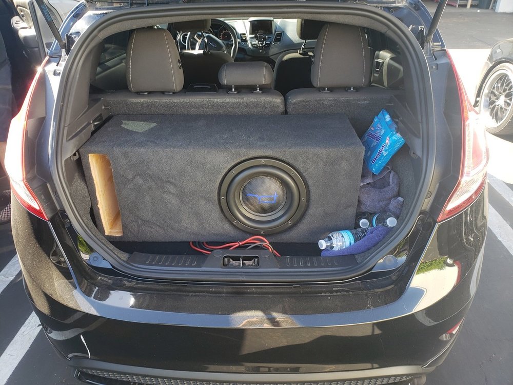

KickerSlo Posted April 23, 2019 Report Posted April 23, 2019 Greetings fellow Bass Heads. Im looking for some suggestions to get a bit more SPL out of my current setup. Any suggestions would be much appreciated. Basically i just want to know if there is enough room for growth thats worth doing before i step up to a 15 or am i where i should be for the combo. Here is the breakdown. 2016 Ford Fiesta ST (Stock interior), 250A Alternator, 2xOdyssey PC-1500 Batteries, 2 1/0 runs from alt to primary battery, 2 1/0 runs from front to rear Battery, Factory Stereo, Wavetech BassFREQ inverter, Orion 2500 XTR, 1x 10" FI BLNEO. Box Designed by CAF.com 1.50 CF @ 45HZ. I also have a DC 2.0K that i havent tried on this box setup yet. Its on my "to-do" list. Just to see what kind of power and SPL im getting out of it. Currently im getting a little over 1700 watts out of the Orion. Current SPL 141.6 @ 43HZ Sorry for the Noobish breakdown and questions. Iv been out of the game for some time and things have changed alot sense i built my last real system. Thank you all for your input.
Joshdashef Posted April 24, 2019 Report Posted April 24, 2019 Involves building a new box but I’ve seen people run sub up port back with great success. Not sure if it’ll help your setup but it’s a thought SMD Tool Map (2024): https://www.stevemeadedesigns.com/board/topic/226545-smd-tool-map-2024/ Great Box Bracing Examples: https://www.stevemeadedesigns.com/board/topic/202148-best-way-to-brace-a-box/?do=findComment&comment=3055002
KickerSlo Posted April 24, 2019 Author Report Posted April 24, 2019 3 hours ago, Joshdashef said: Involves building a new box but I’ve seen people run sub up port back with great success. Not sure if it’ll help your setup but it’s a thought Interesting I never considered that. I'll have to look into that. Thank you.
