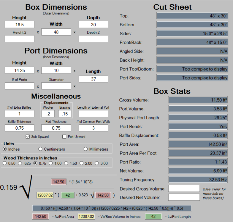

Finally time to build my box, any help welcome. (Cut sheet) (design)
Here is what I would do.  Sub up, port back.
Builds:
I really appreciate the work, but the sub it self is over 15" in depth, so if i reading that right it wont fit?  Also if i have a 25 SSF wont 32hz tuning be to high and unload at higher watts?

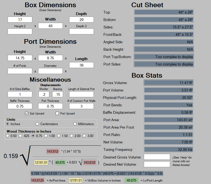

I hadn't considered that the sub was over 15" tall.  Thanks for catching that.  It actually would still fit, but there would only be .5" of clearance between the back of the motor and the bottom panel.  Ideally we would have at least 1".
Your subsonic filter will be just fine.  Typically you set the subsonic filter to a half octave below the tuning frequency.  A half octave below 32 hz is 24 Hz.  Generally your actual tuning comes out a bit lower than Torres predicts anyway.
I redid the design to make it a 1/2" taller for proper clearance behind your sub.image.png.0a6ac9a8bf9b6f5e0175462ce35bbb3c.png
Builds:
Thanks a ton bro, gonna buy lumber this weekend.
