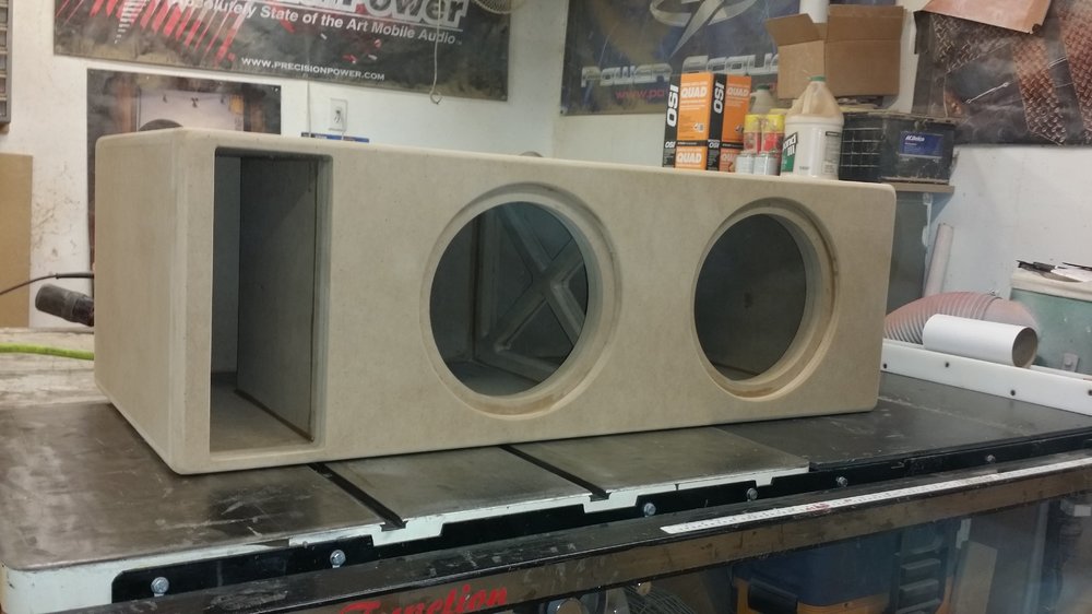

1 common port wall would be a slot port that runs along the bottom of the box such as this *dont mind the 2 center dividers, they are just port braces*.

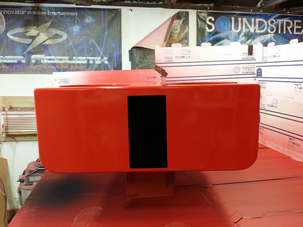

2 common port walls would be a a center slot port that is using 2 exterior sides of the box for the port walls such as this.

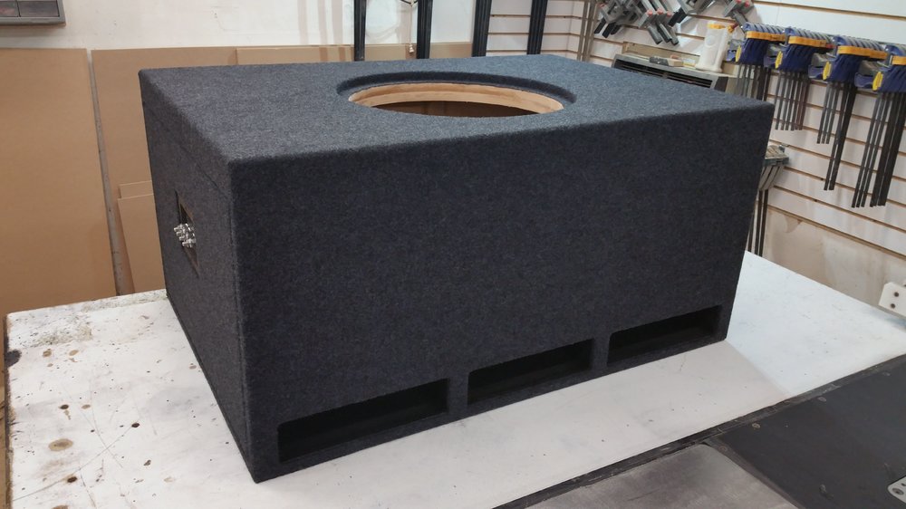

3 common port walls would be a slot port on the side that is using 3 exterior walls to make the port such as this.
