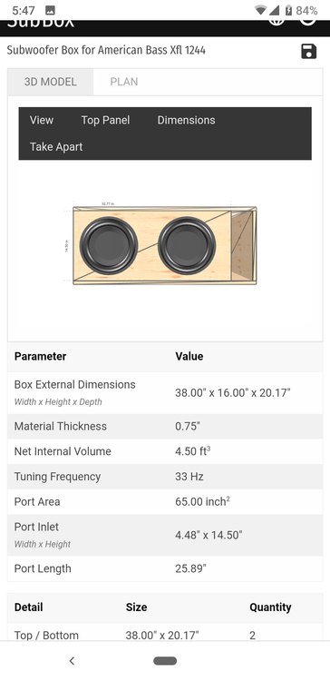

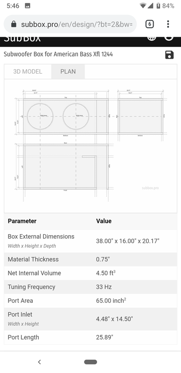

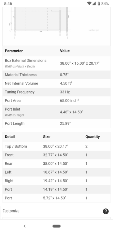

Prefab for 2 American bass xfl 1244
danielbea
Looks pretty good. Your design and build could be made a bit simpler by using an aeroport though. Port area will be a bit lower than achievable with slot port, but install is just cut a circle. Aeroports do have better efficiency due to less surface area, but I'm not experienced enough to say if the loss in cross sectional area is worth it.
One thing on box dimensions...If you're sliding it into a trunk, make sure it can fit through the trunk opening. Sometimes the trunk interior is bigger than the opening and you can get in trouble 😐

Imma give it a shot worse that can happen is I'm out $40 bucks for wood
