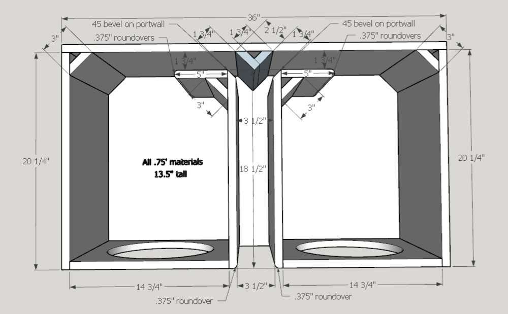

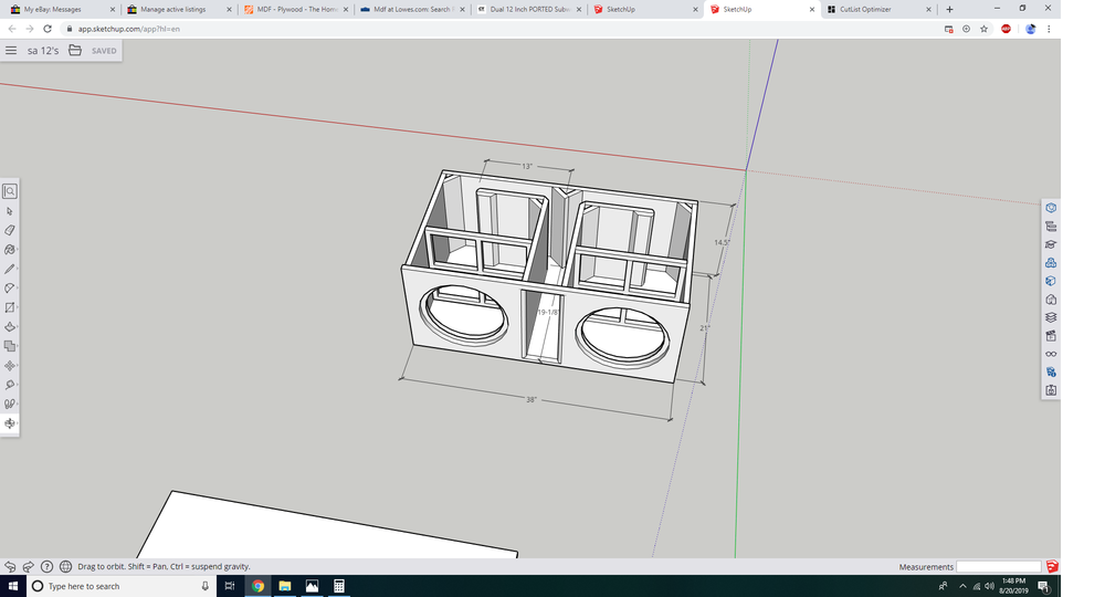

I'm going to be building a new box and modifying my old box with a aero port to see which one is best.  I have 2 SA-12s dvc2 wired to 1ohm each. Running 2 SQ S1-1250's.  My current box lacks port area. Can you look over this box for me. It's my first design.  I most listen to hip hop and just started competing in NSPL.
Box size 38x21x16

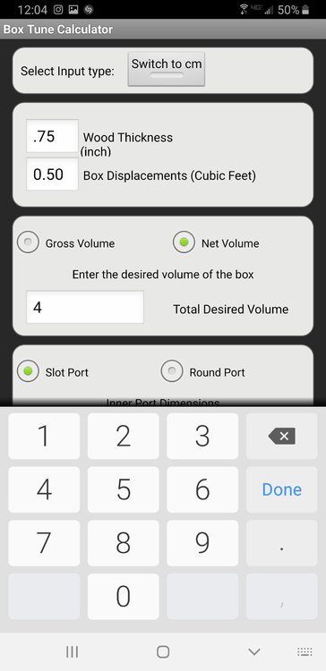

Port 4.5" x 14.5 at 32" long    my calculations should be about 34hz

What's your net volume per sub?
Just from a quick glance everything looks good to me.
Sundown says 1.5-2ft3
Yup everything looks good.  I say go for it.
