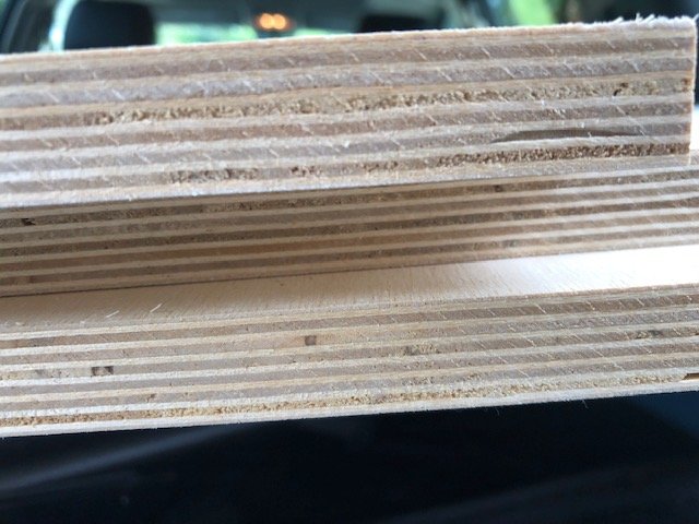

One more thing. I know some people say stay away from the birch at places like Lowes and home Depot. What should I be looking for in the plywood grade. Chances are I will need to get it from Lowes or Menards. If it is definitely advised against then I will probably have to use MDF.

Just be careful. Baltic Birch is different from regular Birch, and has different grading standards and sizes.
Baltic birch is graded B/BB at the highest,to BB/CP (includes patches) and C/C at the lowest. Standard Birch is graded A/B down to C/D. Baltic also tends to come in 5 foot increments as opposed to standard Birch that's in our usual 4x8 sheets. (grades are for front/back faces)
The Baltic stuff tends to be nicer, with no holes in the core, marine grade glue between the veneers, etc... however there's nothing wrong with good A/B grade standard Birch. I can not get the Baltic stuff locally unfortunately (and I live in a mill town). meh.
Ok thanks. I will probably post a link to what is available for me before I purchase it. I don’t want to buy it and then get it cut, or cut it up just to find out I screwed up with the material I purchased. I am thinking regular birch and oak plywood is what is available to me.

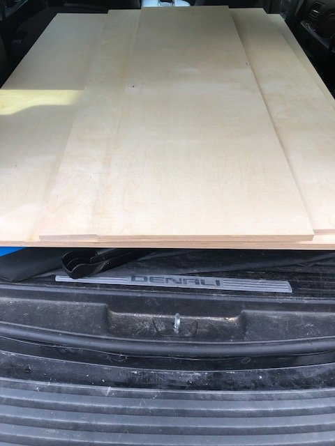

Looks like I can get Baltic birch local for $48 for a 60"x60" sheet I would need 2 of those.
I've got wood! :) Local place had some Baltic Birch. I got 1 and 1/2 sheets of 60"x60" for about $70. not too bad. I am going to start marking it up of the next couple of lunch breaks, and I might take a vacation day friday and start cutting and building the box. More pics to come as I make progress.1036678799_IMG_3868(1).jpg.3b640e313775c6431ccdd2e3167e8b31.jpg1549897980_IMG_3869(1).jpg.d3542e5cafbbb9563687151b4b3a3e9c.jpg

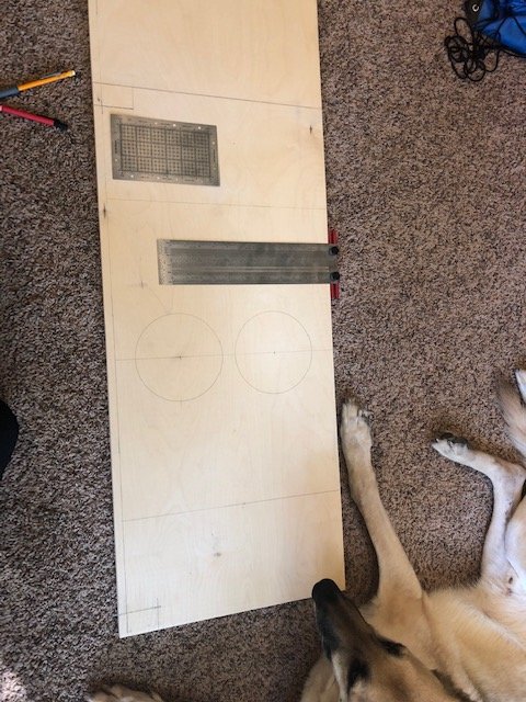

Not much to share. I am waiting to get a firm quote on CNC. in the meantime I thought I would mark up the boards a little more. I have the outline of the front panel with the ports, and the vertical centerline for the subs. Thanks to My helper Max! He is always willing to lend a paw.IMG_3877.jpg.910910a8304a3ec387742421b5f811e6.jpg
