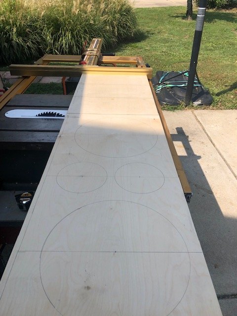

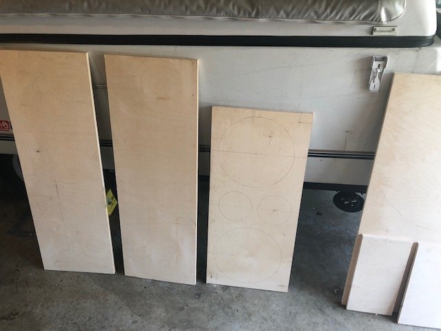

Not much time to work on it today. I did get 2 notches cut out in the front panel. I used my jig saw and a straight edge. I was going to use the table saw and a dado blade, but it was not a stable as I wanted it since it stuck up 36" off the saw. I need to make a taller fence to hold it steady. that will be a project for another time. I did manage to get it pretty square.

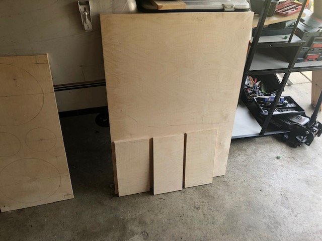

I have almost everything cut. I still have the top and two sides. I also have to cut a notch in 2 more panels. I also have to cut out the holes for the ports and the speakers. I should get that done tomorrow and start glueing it together. Here are the cut pieces so far.

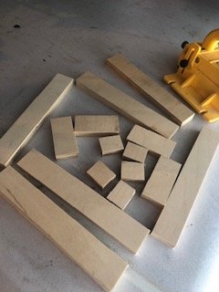

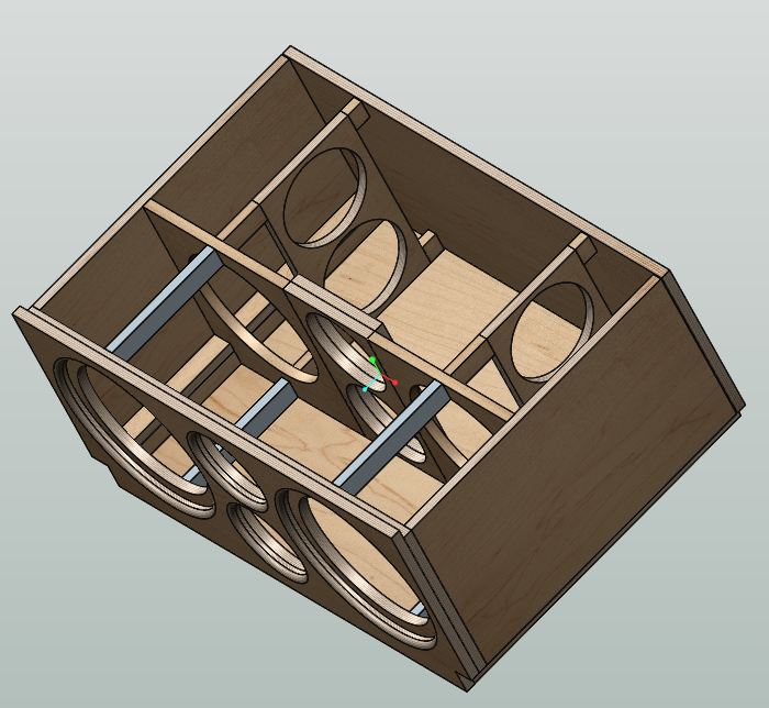

Well I almost had a big oops! I knew the whole time I was going to need to figure out my internal bracing and cut that too. Some how even though I knew I needed to do that, it didn’t get translated to the front of my brain. I remembered it earlier. I had to mock something up and get some dimensions so I could cut it. I will have to cut that tomorrow too before I can start gluing it together. I was almost in trouble as I had to fit my bracing around my ports running down the center of my box. I’ll post more pictures tomorrow.
here is a rough mock up of the box.
Well I worked on the box today. Unfortunately I didn’t get to the glue stage yet. I have all of the boards cut, except the cut outs in the front baffle.
If I would have made the braces a higher priority I wouldn’t have had to have so many small parts. Oh well.

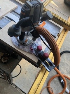

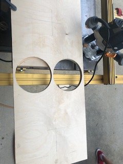

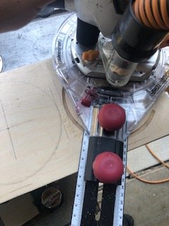

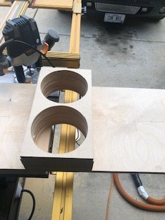

I underestimated the time to cut all of these holes. Took a while longer than I was expecting.
The port holes fit the 6” pvc perfectly.
however I hit a snag. Easy to fix but I ran out of time.

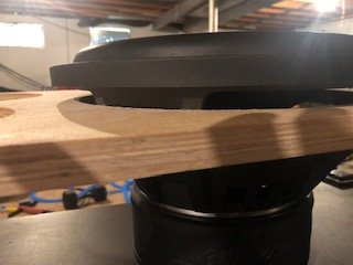

I need to make the hole about 1/8” larger. Sub doesn’t fit.
2 hours ago, Scotnemily said:
Well I worked on the box today. Unfortunately I didn’t get to the glue stage yet. I have all of the boards cut, except the cut outs in the front baffle. I need to make the hole about 1/8” larger. Sub doesn’t fit.
I just roundover the top edge maybe 3/8" and it usually drops right in.
I thought about doing that, but I don’t think it will be quite enough. I did double check my hole and it is to the manufacture specs, but it is off about 1/8” I think looking at it again. I’ll just rabbet it out
