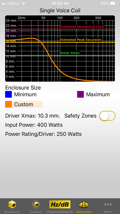

I have kicker kxa800.1
400rms@4ohm
800rms@2ohm
800rms@1ohm
sub is kicker compC 10” svc 4ohm
so power is
1 sub 400rms ea
2 subs 400rms ea (800rms total)
3 subs 266rms ea (800rms total)
i have 4 graphs below

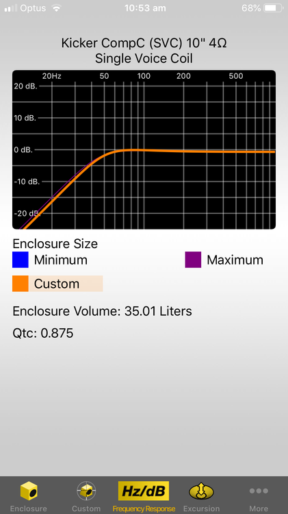

1sub in 35 with 400rms

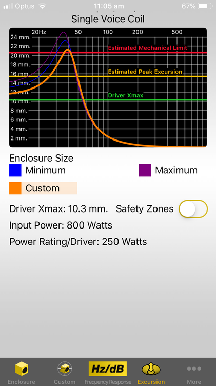

2 subs in 70 with 800rms (400ea)
3 subs in 75 with 800rms (266ea)

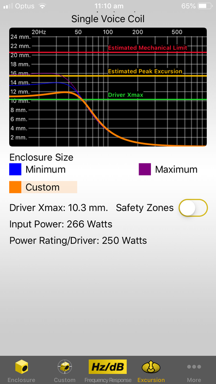

1 sub in 25 with 266rms
why does it change so much when it should stay about the same ie double everything
or do I need individual boxes to keep Xmas down
14 hours ago, CstrokerV said:
Don't understand your question.
If I have 1 sub in 35L sealed box on 400rms looking at the graph it’s fine, where it should be
why when I add a second sub and make the box 70L  and run both subs on 400rms (800rms total) why do the Xmas jump go so high and the graph peek?
to stop this do they need separate inclosers to stop this?
same for 1 sub in 25L box on 266rms grand looks good
why when i add 3 to 75liters and ‘800rms (266ea) they
Trying to work out am I better off with 2 or 3 subs seared on the power an vr
