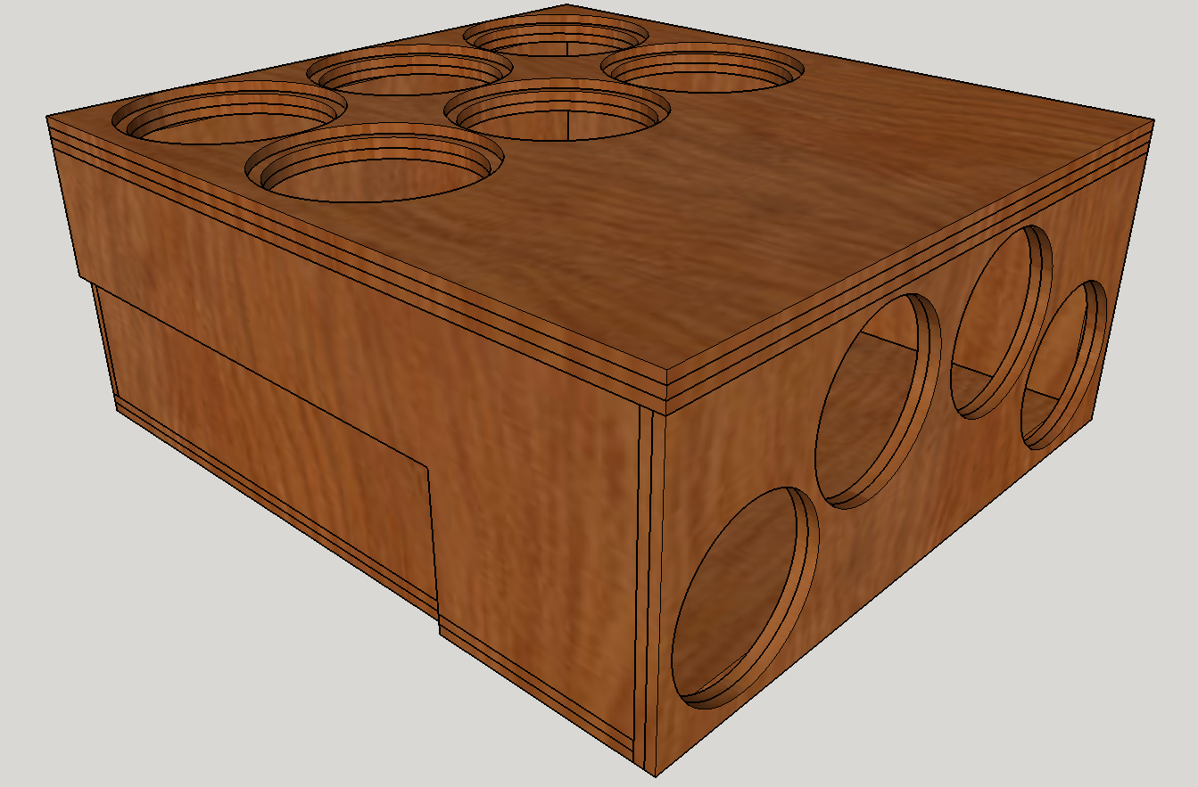

After one last FINAL revision, I think the design is officially a go.  I ended up saving myself a sheet of wood by redesigning it for using 5'x5' sheets of 13 ply Baltic, instead of the HD birch I picked up Sunday.  I just returned the birch to HD, and will be picking up the Baltic this weekend. I'm hoping to get started on the cabin repair and prep tomorrow evening.
