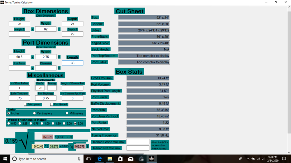

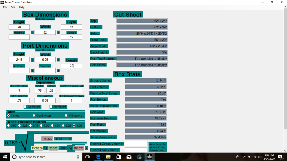

ehall8702 Posted February 25, 2020 Report Posted February 25, 2020 so I just ordered a taramps md 8000.1 2 ohm and had to redesign my box for my extended cab z71. I'm having HUGE problems getting enuff port area with the amount of power I have. ill be wired to 2.67ohms and after rise id figure id be at 4ohms. the amp does 8k at 2ohms and im guessing at 4 ohms ill have 5-6k rms. my max dimensions for the box is 62 wide, 26 high and 22 top depth and 29 bottom depth. to get 9 cubes net ( subs call for 3 each net) and close enuff port area I had to use 4500 rms power in triticums port calculator. I hope that going to be enuff to not cause issues. my other question is using a port on the face the port will be shorter by 7" at the top than the bottom , how does that effect tuning? ( using a slot port because I'm comfortable with em and it adds bracing inside the box at the same time. I origionally wanted to be tuned at 28hz but cant get that low with enuff port area so had to come up to 32hz to compensate. anyone have any suggestions or idea that may help? here is the torres page I ended up with, going to play around more too. this would be face ported, trying to stay on the face because id like to use the top of the box as a "package tray" since itll be the only place I can put stuff inside the cab like groceries or whatever. if I just cant make it work ill port up and put expanded metal over the port or something. 2009 Silverado 1500, 7.5" lift, 37x12.50r17s, Built Gen 4 5.3L ( 4.8l flat pistons, decked 243s, SS2 Cam, Pac 1218 springs, ported intake, 120mm TB, Long tubes, 3" duals HP tuner software tuned by me), 4l80e swapped and 4.56 gears. All done by me. stereo is Pioneer avh 600ex, all stinger rca, jp23 v1.5, skar rp150.4, and hertz hpd4. 2 SHCA 6.5 8ohm, 1 SHCA 3.5", and 1 DS18 tw120pro in each door. The 3.5 mid and 3.5" tweeters are powered by the skar rp150.4, the 6.5s are powered by the hertz bridged @4 ohms. Dual runs of 3/0 welding cable, 300a alternator, 2 Vmax AGMs up front. current sub is a AB XR 12 ( dual 2 ohm) with bottom spider cut out in 2.25 cubes at 32hz

ehall8702 Posted February 25, 2020 Author Report Posted February 25, 2020 that's what I got using whole width as a port on the top, cant seem to get good results with a round port at all. tried 3 10' a few 12" nothing comes out any good, cant get it low enough ( tuning I mean) 2009 Silverado 1500, 7.5" lift, 37x12.50r17s, Built Gen 4 5.3L ( 4.8l flat pistons, decked 243s, SS2 Cam, Pac 1218 springs, ported intake, 120mm TB, Long tubes, 3" duals HP tuner software tuned by me), 4l80e swapped and 4.56 gears. All done by me. stereo is Pioneer avh 600ex, all stinger rca, jp23 v1.5, skar rp150.4, and hertz hpd4. 2 SHCA 6.5 8ohm, 1 SHCA 3.5", and 1 DS18 tw120pro in each door. The 3.5 mid and 3.5" tweeters are powered by the skar rp150.4, the 6.5s are powered by the hertz bridged @4 ohms. Dual runs of 3/0 welding cable, 300a alternator, 2 Vmax AGMs up front. current sub is a AB XR 12 ( dual 2 ohm) with bottom spider cut out in 2.25 cubes at 32hz

ehall8702 Posted February 25, 2020 Author Report Posted February 25, 2020 I come up just shy of optimal port area I think that'll be ok, my issue now is how to calculate port length when at top edge of face of box is 7" farther back than bottom edge of face. Do I just use the middle of that angle to calculate port length? I don't mind being a few hz off but I'm already at 32 when I wanted to be at 28 so if it gets any higher I'm gonna be severely disappointed, cause the whole reason I went with 15s was for the "brown note" ( yeah if ur not a southpark fan u jut wouldn't understand lol). My 8s were mean in the lower 30s and I definitely want lower than that 2009 Silverado 1500, 7.5" lift, 37x12.50r17s, Built Gen 4 5.3L ( 4.8l flat pistons, decked 243s, SS2 Cam, Pac 1218 springs, ported intake, 120mm TB, Long tubes, 3" duals HP tuner software tuned by me), 4l80e swapped and 4.56 gears. All done by me. stereo is Pioneer avh 600ex, all stinger rca, jp23 v1.5, skar rp150.4, and hertz hpd4. 2 SHCA 6.5 8ohm, 1 SHCA 3.5", and 1 DS18 tw120pro in each door. The 3.5 mid and 3.5" tweeters are powered by the skar rp150.4, the 6.5s are powered by the hertz bridged @4 ohms. Dual runs of 3/0 welding cable, 300a alternator, 2 Vmax AGMs up front. current sub is a AB XR 12 ( dual 2 ohm) with bottom spider cut out in 2.25 cubes at 32hz
Scotnemily Posted February 25, 2020 Report Posted February 25, 2020 I designed a box once, (I didn't build it though just want to put that out there) but I mirrored the port slant from the front of the box to the back of the port. so both the top and bottom of the port were the same length the whole port. if that makes since. I am not sure if you can do that in your situation, but It tested good in a simulation.
ehall8702 Posted February 25, 2020 Author Report Posted February 25, 2020 In this box it wouldn't work because the port turns, but I get what ur saying, port wall would look like a parallelogram from the side. May try and put a port on each end and see how that works out, would make life alot easier compared to guessing. Would doing one on each side mean there would be 6 shared walls in Torres ? Man it just gets more and more fun, just hate to waste $250 worth if wood ya know, and 8+ hours for a one off failure. 2009 Silverado 1500, 7.5" lift, 37x12.50r17s, Built Gen 4 5.3L ( 4.8l flat pistons, decked 243s, SS2 Cam, Pac 1218 springs, ported intake, 120mm TB, Long tubes, 3" duals HP tuner software tuned by me), 4l80e swapped and 4.56 gears. All done by me. stereo is Pioneer avh 600ex, all stinger rca, jp23 v1.5, skar rp150.4, and hertz hpd4. 2 SHCA 6.5 8ohm, 1 SHCA 3.5", and 1 DS18 tw120pro in each door. The 3.5 mid and 3.5" tweeters are powered by the skar rp150.4, the 6.5s are powered by the hertz bridged @4 ohms. Dual runs of 3/0 welding cable, 300a alternator, 2 Vmax AGMs up front. current sub is a AB XR 12 ( dual 2 ohm) with bottom spider cut out in 2.25 cubes at 32hz
Scotnemily Posted February 25, 2020 Report Posted February 25, 2020 Yeah that was basically it. I did have a 90 turn in mine though and the port ran along the back wall of the box. just the end of the port that was open had a matching angle to the front of the box. I know what you mean about not wanting to tune higher. I wish my 12"s were tuned at 28. It is right around 30 or 31 now. I might not notice if it were lower, but I keep thinking I would, so that is enough to make me wish I has done it
ehall8702 Posted February 25, 2020 Author Report Posted February 25, 2020 Hell I didn't think about angling just the end like that, that makes sense that'd prolly work too. Probably would have to keep the closest edge of the port however wide port is away from the side which may in itself affect tuning just because it'll limit port length, thank you tho gives me something else to try, I'm GOING to jam all 3 of these 15s in there one way or another! 2009 Silverado 1500, 7.5" lift, 37x12.50r17s, Built Gen 4 5.3L ( 4.8l flat pistons, decked 243s, SS2 Cam, Pac 1218 springs, ported intake, 120mm TB, Long tubes, 3" duals HP tuner software tuned by me), 4l80e swapped and 4.56 gears. All done by me. stereo is Pioneer avh 600ex, all stinger rca, jp23 v1.5, skar rp150.4, and hertz hpd4. 2 SHCA 6.5 8ohm, 1 SHCA 3.5", and 1 DS18 tw120pro in each door. The 3.5 mid and 3.5" tweeters are powered by the skar rp150.4, the 6.5s are powered by the hertz bridged @4 ohms. Dual runs of 3/0 welding cable, 300a alternator, 2 Vmax AGMs up front. current sub is a AB XR 12 ( dual 2 ohm) with bottom spider cut out in 2.25 cubes at 32hz
