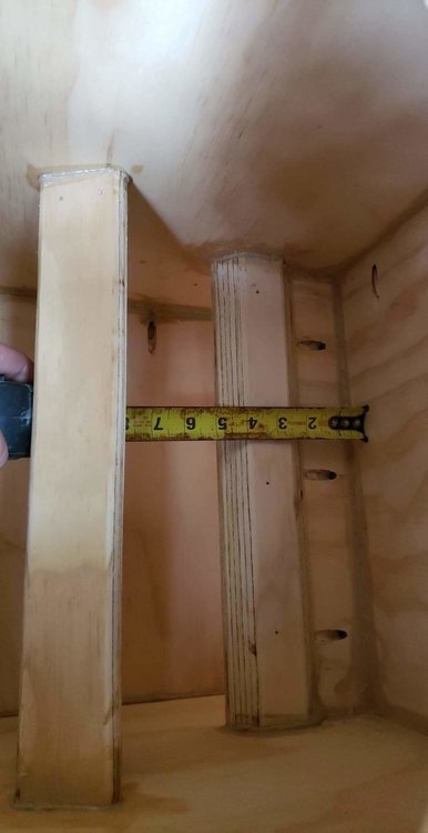

TheMusicBox Posted February 26, 2020 Author Report Posted February 26, 2020 This seams to be to short. But I'm no expert what so ever on enclosure building.
TheMusicBox Posted February 26, 2020 Author Report Posted February 26, 2020 I calculated the enclosure volume is 4.25^ after displacement and port area. Skar calls for 4.0^,so that means this is .25 to big also.
