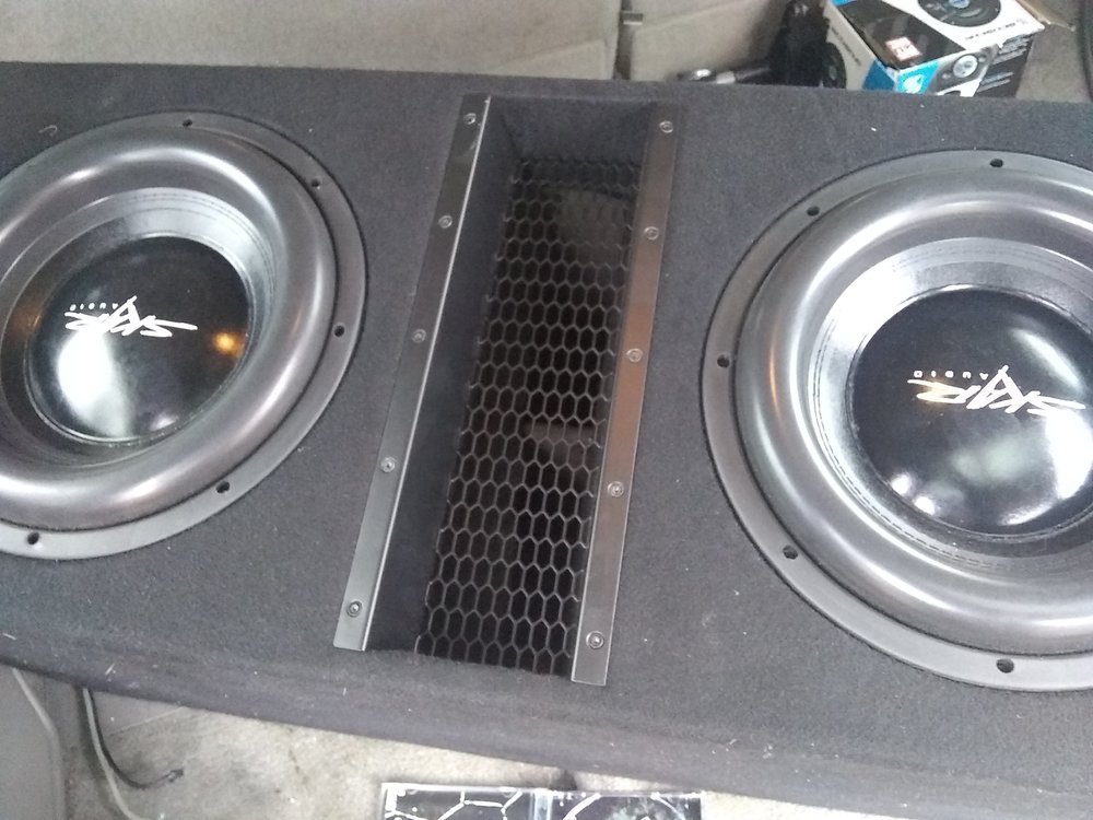

You can, but your enclosure's tuning will be changed as a result. The subs take up a certain amount of volume within the box. Inverting your subs will place the motor structure outside and leave more volume on the inside at a greater amount. If it's prefab from Skar then just leave it as it is. Those guys engineered their enclosure to be packaged and tuned in that way.
