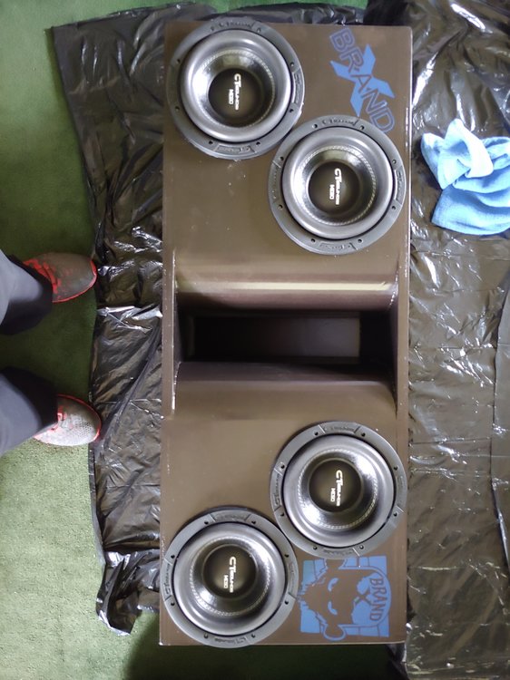

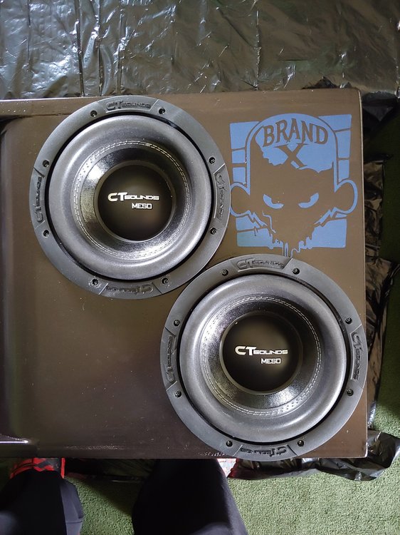

Has a little wrinkle on left side lower sub.
I got 7 fucking can on this, 3 cans primer, 4 cans color and 4 cans matte clear, last coat last cost of the last can of clear I got slightly distracted and slowed down the stroke and a sagging ass run happened.
But I let it tack up some and tapped it flat with my finger, I did best I could.

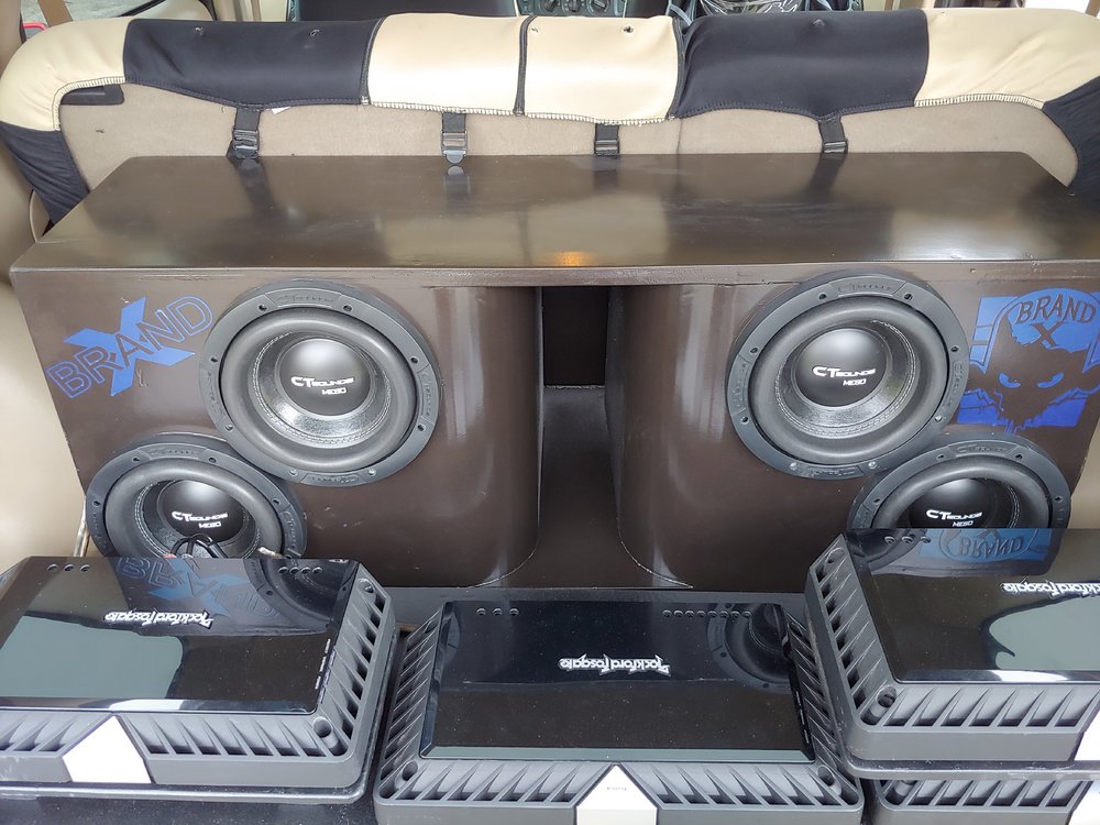

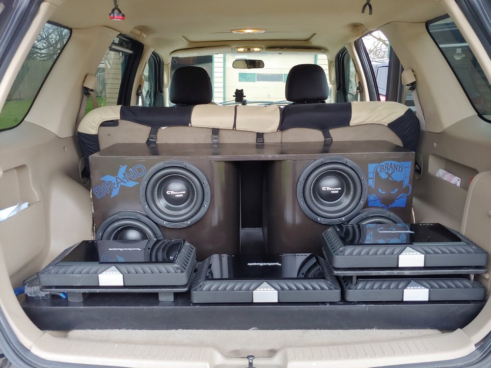

On 4/27/2020 at 10:11 PM, CstrokerV said:
those logos and color of box  ruined that box just my opinion... should of went with the blue stain or some other color... but if the owner is happy with it thats all that matters
It is the color of the vehicle.
I like it.
Didn't have time to play with stain and poly

I'm going to be building my own box soon (hopefully) did you just use spray paint? Grey primer spray, spray paint, spray clear? I think it looks good! The paint is really nice. It's not super flashy. It'll look damn good sitting inside the car.
Yeah Rust-Oleum high build automotive primer.
Then Rust-Oleum metalic (had 10 minute dry to touch, 30 min fully dry time) and matte clear which had a 15min dry to touch, tecoat anytime and full dry 1-2 hours.
I should have given it a whole 24 hours after last coat. Cuzz it was dry, but still soft, where setting a sub on it, or laying it on its side was enough to "smush" the finish from weight.
The full day would have been "hard"
