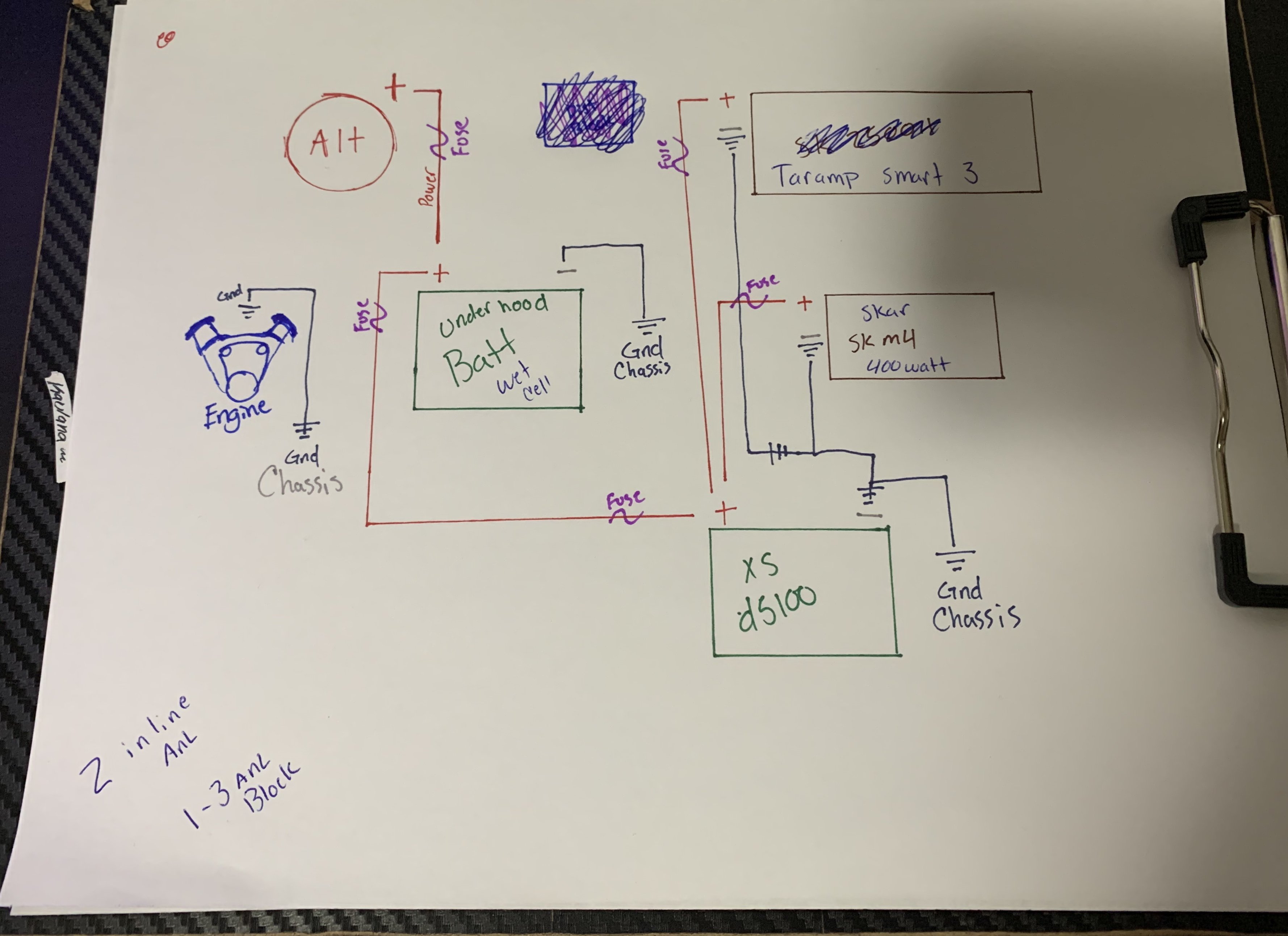

Does this appear to be the correct way it should be wired hopefully from the hours of videos I’ve watched this is correct just need to know anl fuse sizes
You want to ground the amps to the chassis instead of the rear battery post. Them grounds would be too long. The shorter you can get the ground wires, the better. Plus don’t ground the amps on the same grounding bolt. It could create ground loop noise. And since 1/0 awg can only support up to 350 amps of current, get 350 amp fuses. And for 4 gauge wire do 150 amp fuses and for 8 gauage wire do 60 amp fuses.
Okay what’s a good rule of thumb on ground wire Length? And positive wire length for rear setup. Separate ground locations for the three rear grounds is what you are saying? But other then that my diagram is G then
Ideally 18” or below, ideally. If for some reason you must exceed 18” then the less you exceed it, the better.
Okay well here goes nothing lol wife isn’t gonna like the price to get this to happen but between a car accident settlement and stimulus it’s a small chip compared to some people’s set ups. Thanks again for all the help and knowledge really took me to school dude. Excited to hear how loud it’s gonna be in a extended cab.
