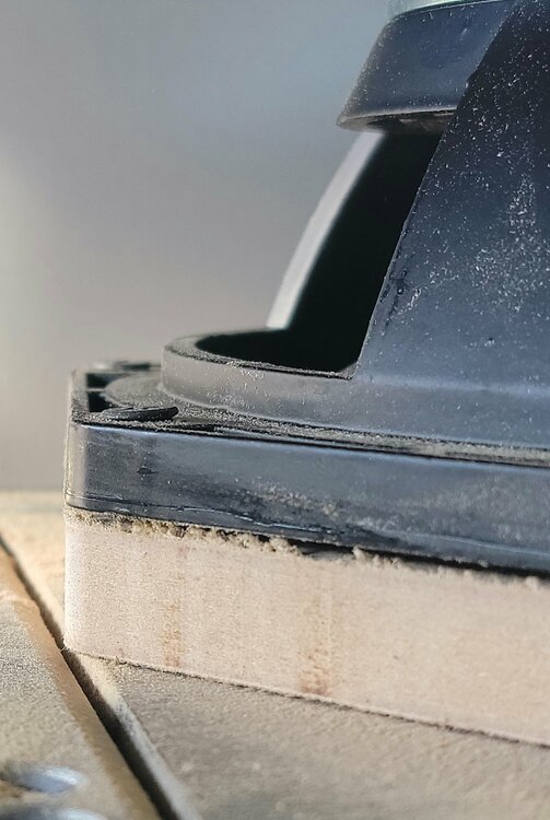

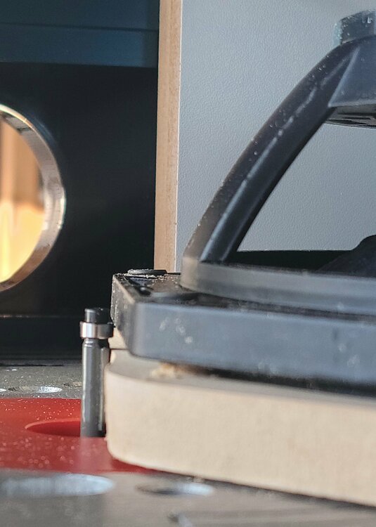

Ok, here we go20211121_144652.thumb.jpg.d682b70dbceb060822bdf0b97e4ea4b6.jpgI'm either going to succeed, or ruin a $135 speaker.
I'm going to use this template to cut nice and tight holes into the upper layer of my speaker baffle
How's that for step 1 in the making of my first template ever? 20211121_145819.thumb.jpg.4dc54b50cc660992a4b509fecee9d6e5.jpgnext, since my flush trim bit is 1/4" wide, I need to take about 3/16's out of the template so the speaker will sit nice and tight in the hole.

Nice, neat, straight router lines! I should have bought one a long time ago!
