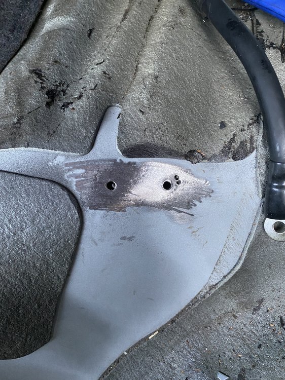

I looked at that closer and it’s a piece of metal on top of the chassis. Bad spot. But still post a better picture so I can see more of the surrounding area.
It is a piece of metal on top of the chassis that is the bottom part of it. Shouldn’t I just drill a hole next to the original ground spot I already have and than just nut and bolt it for my amp ground? Meeting up with my mechanic now I am driving
Just drill a hole in the chassis and do some cutting to be able to but and bolt the grounds. Make sure you clean the metal bare before grounding. Do it with sandpaper or a wire brush.

That would be my amp ground and negative with a nut and bolt. That’s what it comes down to

How are you gonna access the other side of that sheet of metal to be able to nut and bolt the ground?

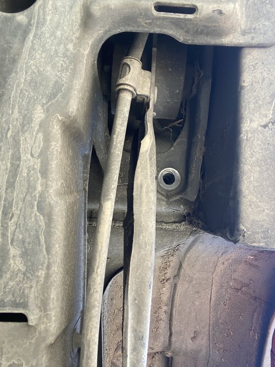

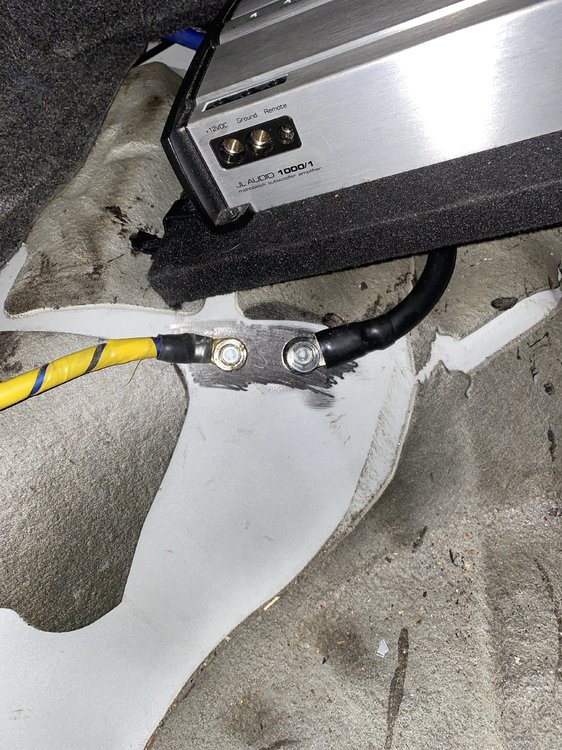

My mechanic was able to bolt it from underneath. The ground I had before was garbage they didn’t even scrape the metal right, everything seems fine right now I blasted it pretty loud on my way home and it did not get hot. You guys are car audio beasts good shit man
stripped screw is a bad ground
no on the 200 amp fuse way too much fuse
agreed a good brand 4 ga. is sufficient for that amp
